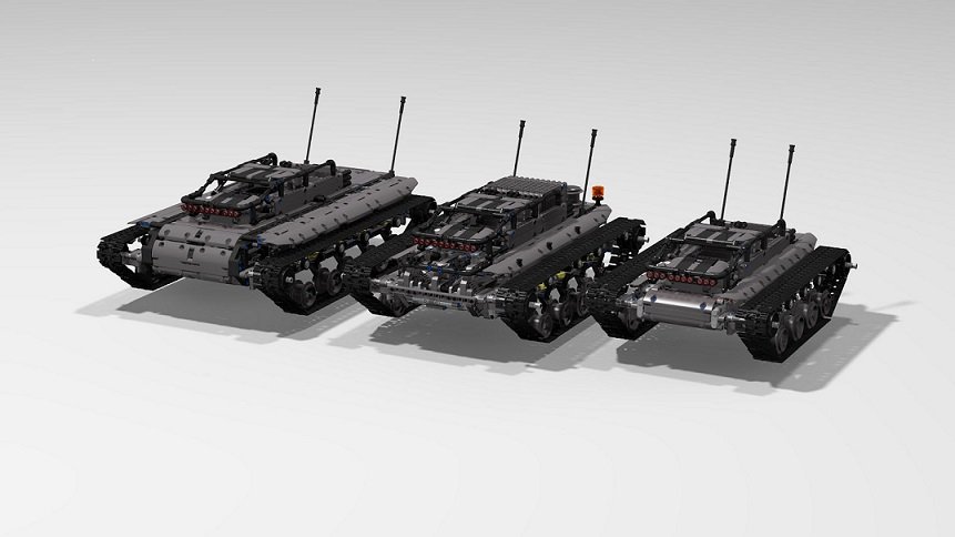

CharlesD Posted October 25, 2020 Posted October 25, 2020 Hi, I have designed a series of tracked vehicle using either 4 or 6 L or XL motors with two buwizz. And the problem i keep having is that after about 30 seconds to a minute the power to one side is shut off. If i then leave it to rest for a minute it will go again, but it will cut out sooner after that. The components to not heat up noticeably. I have experimented with different sizes and weights, and the problem is more noticable at higher speeds and weight. but weirdly enough it runs fine before the "limit" kicks in. I have cross connected the motors so it is not one buwizz that is at fault. Is there some sort of power limit i am reaching? Thanks in advance. Quote

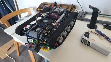

CharlesD Posted November 10, 2020 Author Posted November 10, 2020 After some testing with a laster thermometer i saw that the L motor cuts power at around 28 C on the casing. So i figured i need some cooling and i soldered two molex connector to a Power functions connector, and low and behold this monstrosity; I It works a bit longer but still gets to hot after about two minutes. Is this a problem that other people have seen? there is suprisingly little information to be found about overheating motors. Quote

CharlesD Posted November 10, 2020 Author Posted November 10, 2020 I have two buwizz, and i tried the same setup with 4 motors, but with the same result. I have a feeling that the tracks create a lot more resistance, it makes a hell of a noise. The chassis is pretty much fully enclosed so there is little cooling from airflow. Quote
amorti Posted November 10, 2020 Posted November 10, 2020 Your pic is poor Res, but I did think the tracks looked pretty taut. Quote
