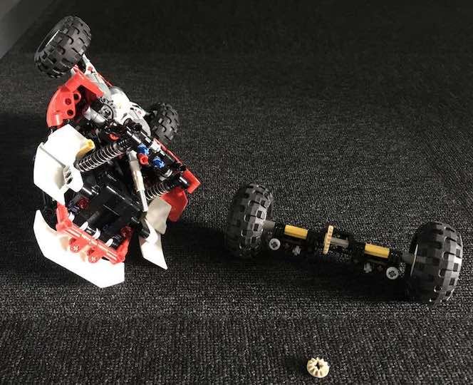

michald69 Posted June 20, 2018 Posted June 20, 2018 (edited) Hi @Anto, Great work, really! Finally, I build the buggy yesterday and it's looks amazing and it's fast as hell! :) But...there is one, a really big problem. Please, check the attached file. When the buggy has few collisions, for example with wall, or I'm speeding up and immediately go back, then real axle is disconnected from rest of the car. Did you have the same issue? Edited June 20, 2018 by michald69 Quote
Anto Posted June 20, 2018 Author Posted June 20, 2018 I had the same issue after crashs, but that was not a problem at all when I drove it (even forward/backward) When I have some free time, I see if I can upgrade the axle to prevent it from disconnecting from the rest of the chassis. @Permo : haha Quote
