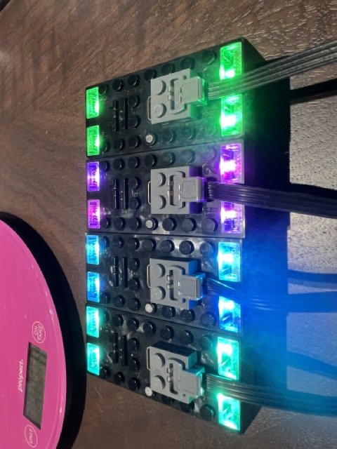

Hi guys, I bought 4 buwizz 3. Very powerful, but several downsides:
1.brickcontroller 2 doesn't support center steering of pu motors
2.Neither buwizz app or brickcontroller 2 support angle positioning of pu motors(like you cant use pu motor to shift transmission easily)
3.buwizz app doesn't support ps controller, yet. Buwizz told me they might roll out ps5 controller in a month. Cant wait!
That's all. Nice to meet you guys here, and sorry for my terrible English:)
