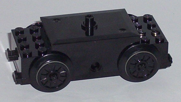

As far as I  know, it's possible to use ordinary RC train motor:
Posted Image
to drive the train, using PF-9V connector.

I have not used the PF motors so others have to answer your questions about that but I have used the 9V train motor and this is what you need to use it:
Battery 8878 + 8887 or 8881
IR receiver 8884
Extension Wire 8871
Motor 8866

OK that helps.  Do these come with instructions on how to use them?  And for the IR receiver what part or section does the receiving of the signal?

If you use the parts I described I think it is very simple to do it right. Just connect them in the order I listed them.
And of course you need a remote control also 8879
