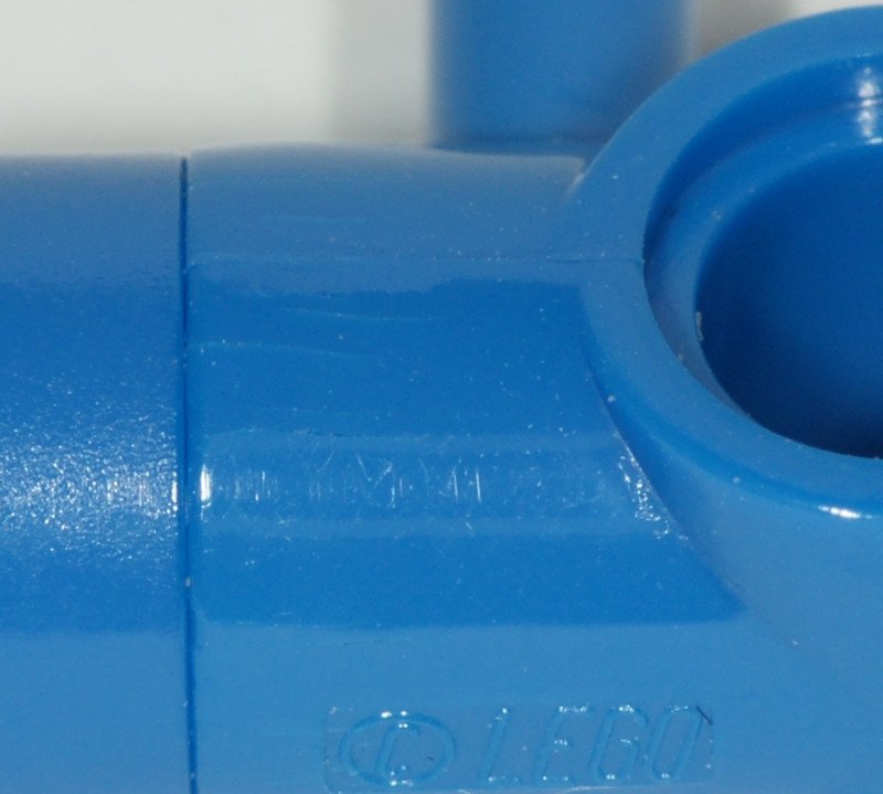

As Timoonn has stated - Contact LEGO service in your country. Go to the LEGO website specific to your country and look for the 'support' link. In there you will find steps to replace broken and missing bricks etc - I just used that link and then entered my details etc... -
19482c01 Pneumatic Pump Fractures
Costas replied to Costas's topic in LEGO Technic, Mindstorms, Model Team and Scale Modeling
Just to follow-up, LEGO Service replaced my spare pumps with the reinforced version bb875. All good...! -

I note that LEGO have released a reinforced version (bb875) of their small 6L pump where they have beefed up the material around the base of the pump. I suspect that the following problem is why they released a reinforced version in 2018. I have a number of 18482c01 pumps which were sitting around in my spares currently unused. I needed one today for a small compressor project and when I put it to use I noted that I had an air leak in my system. Upon closer examination of my pressurised components I tracked the issue to a leaking pump. I placed it in some water (under pressure) and found air escaping through the body of the pump. Under some magnification I noted what appeared to be stress fractures in the main body of the pump - These run 360 deg around the whole base. Note that this pump was new/unused - I also went through my spares inventory (6 new pumps in total) and found another one with the same problem, so 2 out of 6 seemed to be affected - although the second pump exhibited fractures around its base it was still airtight. Just wondering whether others have experienced the same...? Below is closeup where you can see the fractures running lengthwise along the base. There is a thread a while back discussing a similar issue on an earlier pump variant that exhibited a similar problem but that may have just been a one-off:
