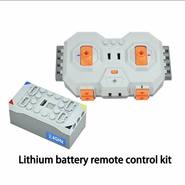

  15. Has anybody checked if only screws were added and no other changes made inside?
  16. I’ve ordered MK M-0005 Servo motor and MK 6 ports hub. Will check it asap when it arrives. This combination should have proportional control. BTW do original Lego Servo Motors work with 3rd party hubs? Proportional etc. Still looking for a 4 ports PF hub with proportional control on 2 channels + 2 buttons. Like Lego 8885 IR with 2 sticks, but with additional buttons - like this one from CaDA:
