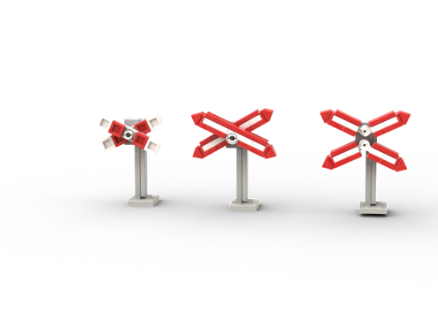

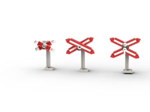

  9. Has anyone come up with a good way to build the red/white St Andrew's cross that marks an unguarded level crossing (UK - I think it's a general sign for level crossing elsewhere in Europe)? I've got a couple of OK brick-built concepts, but they're not brilliant and a bit large anyway; does anyone have any suggestions?
