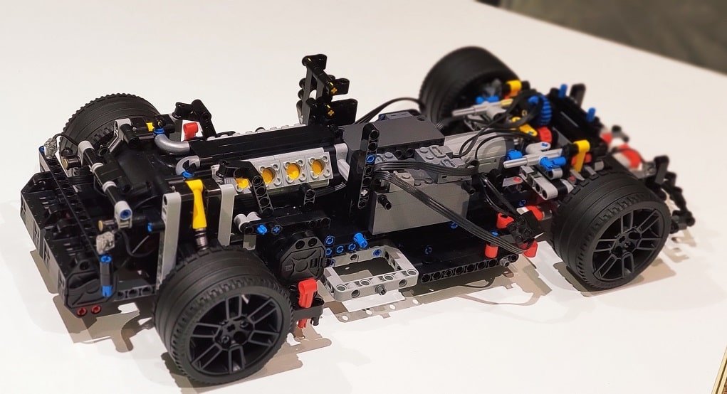

  1. Hello, I'm really struggling with servo calibration. I have build a MOC (kind of racing prototype) using a PU Large motor for steering. The MOC is powered by two Buwizz 3.0 as I use the 4 PF ports to power 4 buggy motors. After having spent some time with the servo calibration failures (half turn and then nothing else) I eventually found out a working PU port. Despite the calibration being successfully completed (+90, -90 then center). I have two main issues: - it seems I'm only able to use the steering if I connect the Xbox controller. - Once I drive the MOC, the steering does not return to its zero position when I release the joystick. It only goes towards the center a little bit. Any help is greatly appreciated. Thanks.

  6. Small update. I completed the chassis. I confirm that it can go straight even if the motors are not perfectly identical. it also drift, I hope the link works. I will now focus on the body work. Here the link to a short animated GIF of the car spinning in "Normal" speed. https://imgur.com/a/lGYE5mY In fast you have to watch not to trigger the over protection. In ludicrous... I have not had the courage to try.
