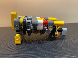

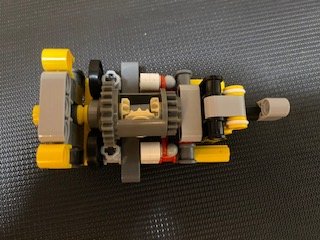

  3. This is a new stepper designed for use with the power functions servo motor. The output will spin 90 degrees every time the servo fully turns to the right or left and returns to center. The basic concept is that when the servo leaves it’s center position one of the ratchets on the differential housing disengages. As it continues to rotate the other ratchet stops the housing from moving, rotating the output. When it returns to center the engaged ratchet allows the housing to slip, so the output remains stationary. If you plan on building this yourself and it is not turning reliably check that the ratchets can rotate easily and the rubber band has enough tension.

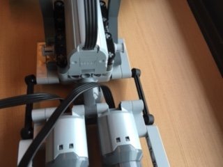

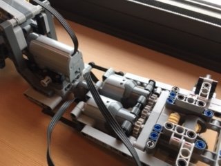

  10. I am working on a trophy truck. I am having problems with the rear live-axles articulation. It only turns about 20 degrees. Is this because the links are located far away from the ball joint or is it something else?
