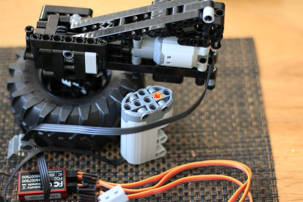

  3. Yes, I used your latest lxf as my basis and imported that into stud.io. Then I made some changes to fit my needs. For example attached is an image how i reinforced the swing arms and changed the gears. I'll iterate on this to get it somewhat cleaner. But for the moment this seems stable enough. The gears in your version broke within the first 10 seconds in my setup. I use a proper RC remote and built a little circuit to control the motors smoothly. You can also see the center position of my servo. Maybe I should go to the lego store and demand a replacement. I bought it brand new recently. I'm looking forward to find out how you put the swing arms together. I honestly have no idea how you've managed that. If you look closely at the image, you'll see that I have to put some pins through the lift arm into the motor from the outside. As a result, I have to push the wheels 1 stud further out. That's not optimal.
