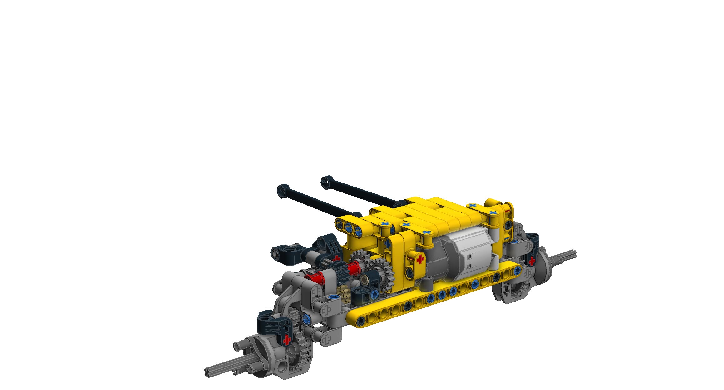

  4. Thank you for that source. I'm trying to gauge which would be best for my current plans, XL motor for torque and weight at the cost of size, or attempt to gear a L-motor that will be capable of pushing my crawler while giving me bursts of speed if needed. Also the bonus of a minimal design is a bonus too. These are my rough plans so far for a rear axle. Any suggestions are welcome. I'm thinking of using 1x11 length long arms for the bottom 2 links in the 4-link setup.
