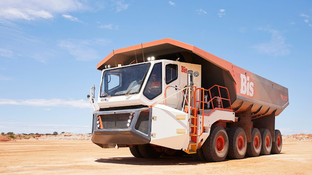

KirTech LAB Posted May 4, 2021 Posted May 4, 2021 Hi! I’ve finished new MOC, a scale model of huge mining truck REXX produced by Australian company BIS Industries. The real truck is 14,3 m long and can carry 160 tons :) The scale is 1:15, so my model is 95 cm long. The total weight is 8,5 kg. My truck contains 15 motors and 4 BuWizz receivers. Functions: - AWD, five buggy motors, twenty tractor tires - Suspension, solid axles - Steering 10 x 6, three servo-motors - Bin unloading, one XL and one L-motor - Ladders, two M-motors - Doors, two M-motors - Wipers, M-motor Enjoy the video :) More photos on my Flickr: https://www.flickr.com/photos/141718063@N06/albums/72157719145182635 Thanks for watching :) Quote

1974 Posted May 4, 2021 Posted May 4, 2021 (edited) A monster! However, I'm surprised how small and normal looking the actual truck is compared to those gigantic CAT and Komatsu haulers. Quite a different approach Edit : It's also not diesel-electric. Interesting https://bisindustries.com/rexx/ Edited May 4, 2021 by 1974 Quote
