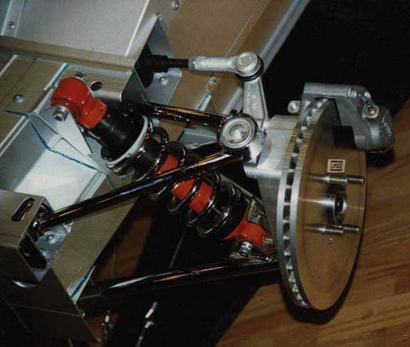

After spending some time in Silicon valley with NSLC, I noticed the many Tesla vehicles in the area, and was inspired to make another road-going vehicle. This time I want to focus on making a proper suspension setup based on either the Tesla Roadster or Model S, as well as a slightly different drivetrain in order to make room for the rear axle setup.
The reason I made this topic is to get some useful info about parts I could use in order to recreate these setups as realistically as possible while still retaining strength, as I hope to use them in an RC MOC capable of 19+ kmh. Here are the photos:
Lotus/Tesla Roadster front suspension:
Model S front suspension:
It doesn't have to look exactly the same, but rather perform the same functions. As for scale, the shock absorber I plan to use is this one: 48912c01.jpg

Personally, I'd avoid the dual lower pivot type design that's shown on the Model S. Those tend to require high steering forces as they approach lock.
What scale, and what wheel size, are you looking at using? Vehicles under about 1:10 scale (or with wheels smaller than the 62.4x20 ones) tend to be too small for advanced suspension geometries, custom kingpins, etc.
