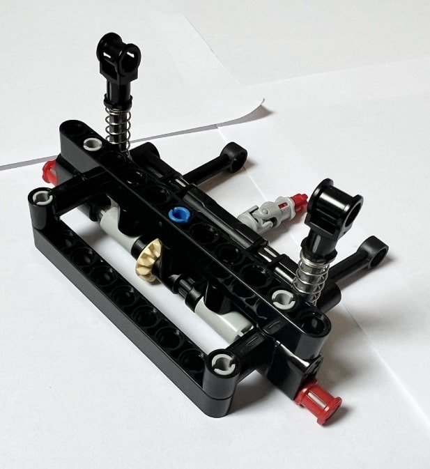

Hi everyone,
I’m looking for suggestions on how I can improve my axle design. I’m currently using a modified version of a design by P-LEGO.
This current design wasn’t able to cope with the weight of the finished build (wasn’t particularly heavy either), as the wheel hubs are only supported at the top causing the wheels to bow outwards at the bottom.
The model will be used for off-roading so I need something with fairly decent ground clearance. I’m trying not to used modified parts except for the springs from the suspension pieces. I also plan on using the 56904 wheelset.
As the rest of the model is complete, I’m rather awkwardly limited to these compact dimensions, otherwise it’ll be a total re-design which I’d rather avoid if possible.
Any help would be greatly appreciated!
Thanks!
At this size, not much fundamental improvement is possible if you want to preserve ground clearance. What size of wheels do you use?
Did you try using black friction pins instead of the grey frictionless ones to mount the 'wheel hubs' to the cross beam? That's what I did and it worked okay for me, although with a light model. At this scale a model should be small, how did you build it heavy? Is it a big truck?
Also, why do you use a 11L beam on the top when the axle is 9 wide? It will collide with the rim, no?
Thanks for the reply, the overall model isn’t too heavy it’s a small AWD car, which is why I was surprised when this design didn’t work too well. I plan on using the wheels part no. 56904.
I found that the 11L beam helped to stop the wheels from bowing outwards, luckily the wheels have a slight lip on them allowing the them to just clear the beam. Thanks for the suggestion, I’ll try replacing the grey pins with the friction ones and see if it improves it.
I think the main problem is that the universal joints slide along the axle, so I might have to sacrifice a bit of ground clearance in favour of making it more secure.
Ah, so that's the thinner one, that does clear. What tires do you want to put on them for an offroader? Does the tire also clear?
