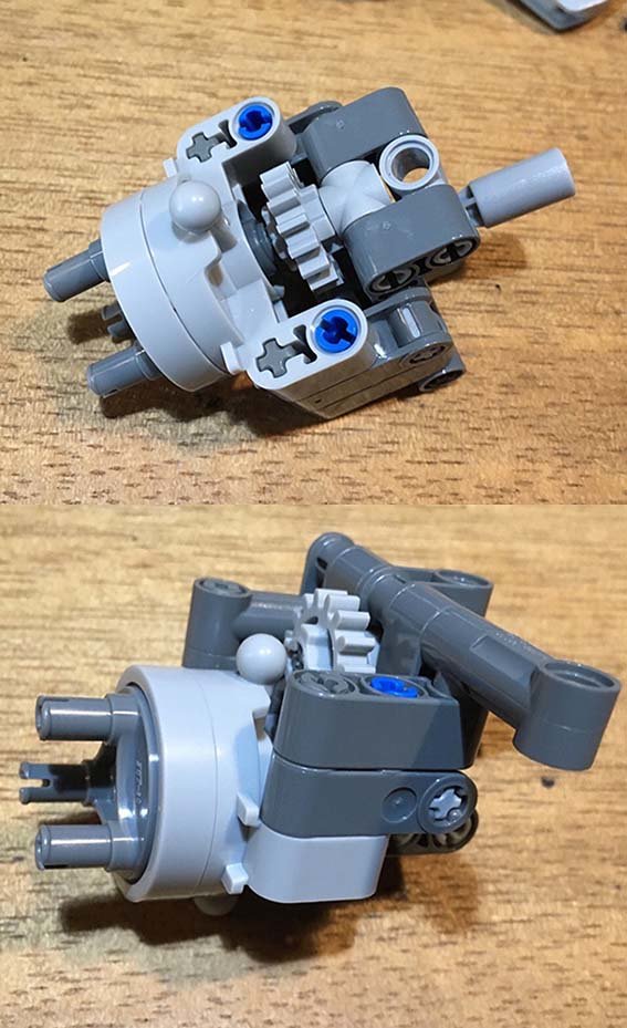

Zerobricks Posted September 20, 2021 Posted September 20, 2021 (edited) Here's an idea I just got and simply had to test it. I discovered the old female CV connector 92906 can mate with the planetary hub's female CV joint! This allowed me to create something really unique, a portal+planetary hub hybrid: I had to use a combination of an older 14 tooth gear and a 20 tooth bevel gear in order to transfer the power: The reason for using half gears instead of normal full gears lies in the way the 92906 mates with the planetary hub, it can't slide in all the way. That's also why the lower attachment point uses a connector in such odd orientation. This combined hub has several advantages to the old portal hub (92908): A much higher end gear ratio - 7,71 compared to 3 Closer pivot point - using the rims from Defender/Ferrari the steering pivot can be a stud closer to the wheel Much stronger driveline - since there are no 8 tooth gears, U joints or axles to bend, the axle can withstand much higher forces Better gear protection - The gears are much less exposed to debris Here's a very basic axle setup with a diff lock. Such an axle has a massive 1:18 tooth gear ratio and I think with a bit more work it will be suitable for really massive and heavy (5 kg+) offroad models. Who knows, I may use it to make a proper large scale truck trial Unimog. Of course I built and tested the hub from real bricks too and I'm planning to shoot a video of the hub assembly shortly, so please stay tuned. Edited September 20, 2021 by Zerobricks Quote
gyenesvi Posted September 21, 2021 Posted September 21, 2021 6 hours ago, Zerobricks said: I discovered the old female CV connector 92906 can mate with the planetary hub's female CV joint! This is really interesting, as I just had an idea (posted in Efferman's thread that includes another custom part as well) that would require a male CV connector with a 2L axle, almost what you discovered here. Imagine a planetary hub at the end: It's too bad that it does not go all the way into the hub part, as this use case would require that, I guess this would not fly, the cross connector would be too close, right? I don't have the old CV's female part to test (just ordered a few). How is the steering angle with that mate with respect to the standard one? The axle looks really promising by the way. Quote
dpi2000 Posted September 21, 2021 Posted September 21, 2021 (edited) 11 hours ago, Zerobricks said: Here's an idea I just got and simply had to test it. Hi, I also used female CV 92906 to build a test sample, two years ago. But needs to be modified with 92906, I happen to have a lot of broken parts. Your idea is more ingenious. ;) https://vk.com/video511631021_456239033 Edited September 21, 2021 by Milan Do not quote the whole block of text and pictures, please. Quote

pleegwat Posted September 21, 2021 Posted September 21, 2021 (edited) 16 hours ago, Zerobricks said: I discovered the old female CV connector 92906 can mate with the planetary hub's female CV joint! I gave it a try, and it should be noted that while it mates it will not pivot at all. Or am I doing it wrong? Edited September 21, 2021 by pleegwat Quote
gyenesvi Posted September 21, 2021 Posted September 21, 2021 31 minutes ago, pleegwat said: I gave it a try, and it should be noted that while it mates it will not pivot at all. Or am I doing it wrong? I think it does not matter for those applications above, as it is fixed in both planes since neither the suspension, nor the steering is implemented through that connection; steering is taken care of the joint above it, suspension by the floating axle into which it is built into. However, it's good to know, that means it would not work for my application, because I wanted to steer through it.. Quote
