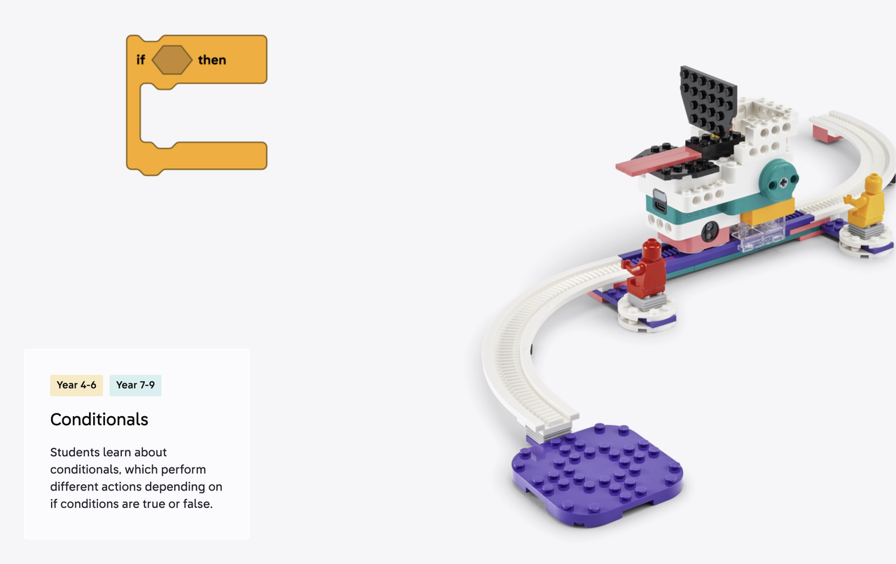

Mr Hobbles Posted Monday at 12:04 PM Posted Monday at 12:04 PM (edited) This morning Lego announced their new Computer Science & AI kit for the Education market. Aside from the usual electronics components (same as their last Science kit), the pictures reveal what looks to be a new track system! There are straight pieces and quarter-circle pieces, and there's a gearing system on top. Their promotional videos for the set show a motorised robot climbing up and down a vertical piece. There's also a new 4x4 piece that holds a gear internally that looks like it's designed to wrap around the track. This looks like it would be perfect for some kind of a monorail system. It's a shame that the curves are only in white right now, but in my experience there's no way Lego makes new parts like this purely for a Lego Education set. So are we going to see inclusion in Lego City soon? https://education.lego.com/en-gb/lego-education-computer-science-and-ai/ Here's a picture I took from their website showing the track pieces, along with the 4x4 transparent "gear and grippy thing" that holds the build on the track. Edited Monday at 06:37 PM by Mr Hobbles Quote

Mr Hobbles Posted Monday at 03:57 PM Author Posted Monday at 03:57 PM (edited) 23 minutes ago, dr_spock said: Can the new tracks attach between regular train tracks such as for making a cog railway? That's a great question. My guess is the straight track pieces yes - they look to be three studs wide with stud attachment points underneath, but the curved pieces no - the radius looks too sharp to fit inside the existing Lego train tracks. Edited Monday at 04:09 PM by Mr Hobbles Quote
Mr Hobbles Posted Monday at 04:56 PM Author Posted Monday at 04:56 PM Here's a better picture of the piece that clips onto the track and holds the gear Quote
Pelzer117 Posted Monday at 11:44 PM Posted Monday at 11:44 PM Exciting. To avoid the problem with the curves, you could also use a mountain railway with straight tracks. The straight track section has 2w (two studs wide) so it would fit nicely in the middle of the normal 6w train tracks. It would be really amazing if there were even enough space for the 4W tracks. Then you could build narrow-gauge mountain railways. Quote
