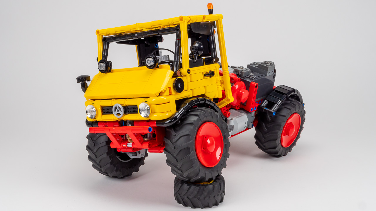

nico71 Posted December 2, 2025 Posted December 2, 2025 A 1:15 LEGO replica of the Werner Uniknick, an unimog based articulated forestry truck from 70’s. Features 4×4 transmission, articulated steering with linear actuators, winch, fake engine and openable elements, built for the mid scale truck trial competition for the 2025 Buwizz Gathering. Specs : Werner Uniknick UK52/60 Torpedo Cab (German info website) Dimensions : 30 x 16 x 19.5cm, Scale : 1/15, Wheels : Ø81mm Built for the 2025 Buwizz Gathering mid scale truck trial competition Power functions Motors (Drive : 2x L, Steering : 1x M, winch : 1x M) Battery source : Buwizz 2.0, compatible with any PFS 2.4GHz controller that connect to PFS motors 4×4 drivetrain with differentials (compatible with red 28t crown) and portal hub (gear : 20/24 and 8/24) Removable working OM616 i4 fake engine Steering with dual linear actuators, working steering wheel in the cab Suspension : central oscillating articulation limited by a connecting rod Openable hood and doors Winch with M-Motor and worm gear / 8t gear Control+ motor swapping possible with reworking the rear axle frame length Ghost view of the functions : See in action : With my irst participation to the buwizz Trial Truck competition, not the best but succeed to finish the race with almost every pieces (RIP the exhaust) ! Links and infos More picture and instructions can be found at my website, and rebrickable with the partlist : https://www.nico71.fr/product/werner-uniknick/ https://rebrickable.com/mocs/MOC-241304/Nico71/werner-uniknick/#parts You can use any electronic source, as long as it handles the PFS motors and with the same form factor as the buwizz 2.0. Using Control+ motor is possible but required to extend by one stud the rear chassis, and the hub will be placed on the top which can block the winch. Feel free to comment, ask question 👍 Quote

gyenesvi Posted December 2, 2025 Posted December 2, 2025 Such a cute model, I like the shaping a lot! It's a unique concept well fitted for the lego portals (as the hubs are not steered), and the articulated steering is nicely implemented with the linear actuators. Unfortunately, for competition use, the steering might be too slow, if you need to go back and forth, to clear the gates, no? Quote

nico71 Posted December 4, 2025 Author Posted December 4, 2025 (edited) Thanks for your comment ! Here is a picture of the real one : And some old footage : Indeed the articulated steering is not the best for trial truck, ultimately because the center of gravity are affected while turning and balancing. So as long as it remains on the support polygon, evertyhing is fine, but when it goes out, the model tip over easily. The steering made by linear actuator make it accurate but a bit slow, so yes, back and forth movement is tedious. I can put a servo steering directly on the articulation, with buwizz servo control, I can have both accuracy and speed, but I do not want to always power on the steering actuation during a turning to keep some power to the motors. I find the linear actuator more aesthetically accurate to the reality (hydraulic in real). The portal hub is very usefull to have the output at the same height of the chassis but being a 4x4, it block a lot on the root as shown on the video. A 6x6 will have a better performance here, or a 8x8 Tatra style with a very short distance between axle 2 and 3. I have not use the winch during the truck trial. I think it can help and we are authorized too, but to have some pulling power, it is geared down and so are slow, so the needed time to unwind, attach, wind, detach, wing will take more time that just try and retry to pass the obstacle I think. At final, this is primarily a reproduction of a forest truck, that I bring to a trial truck competition so not the best in term of performance as not intended too. Now I need to create sort of attachment to the front and/or rear ^^ Edited December 4, 2025 by nico71 Quote

Cypr-21 Posted December 16, 2025 Posted December 16, 2025 Hi Nico, Wouldn't it be better for playability to use connecting rods instead of mini actuators ? Quote
nico71 Posted December 17, 2025 Author Posted December 17, 2025 (edited) Totally, but the aim was to share the most of the parts between the two versions in order they are upgradable by just adding the motors without the need to all dismantling. The speed is not that bad with a gear multiplication and tiny knob. It also enable to lock the model in position which is important especially in articulated steering when offloading (even by pushing by hand, it avoid an obstacle turning the steering). EDIT : I assume you talk specifically of the manual version Edited December 17, 2025 by nico71 Quote
