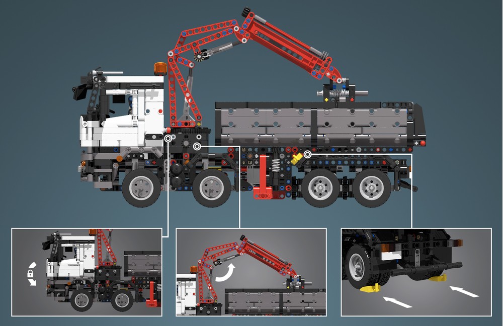

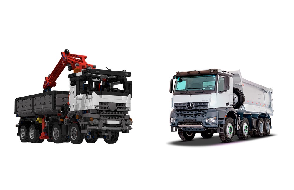

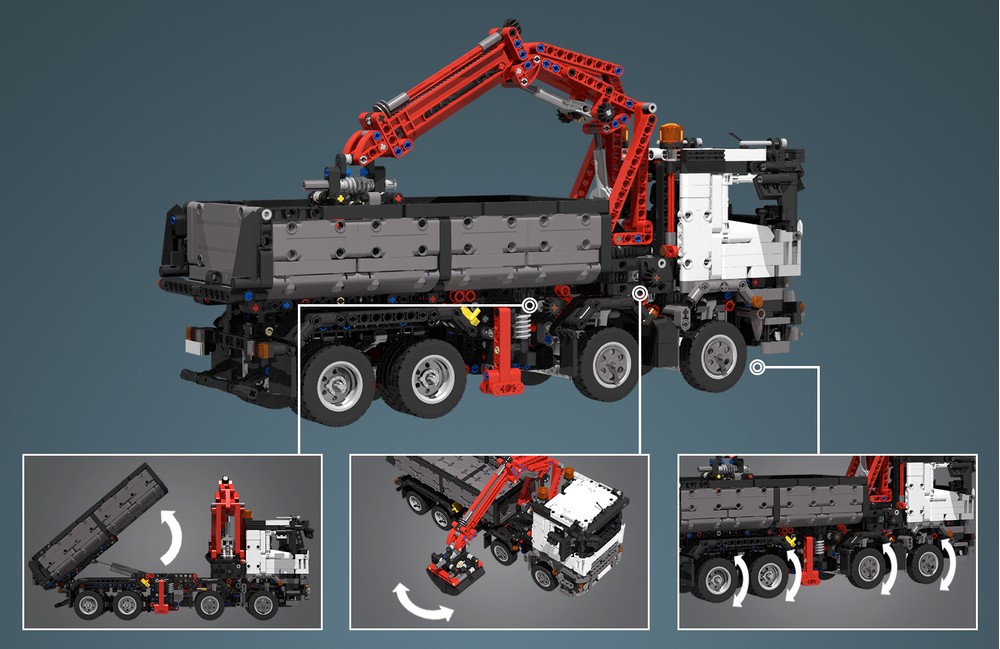

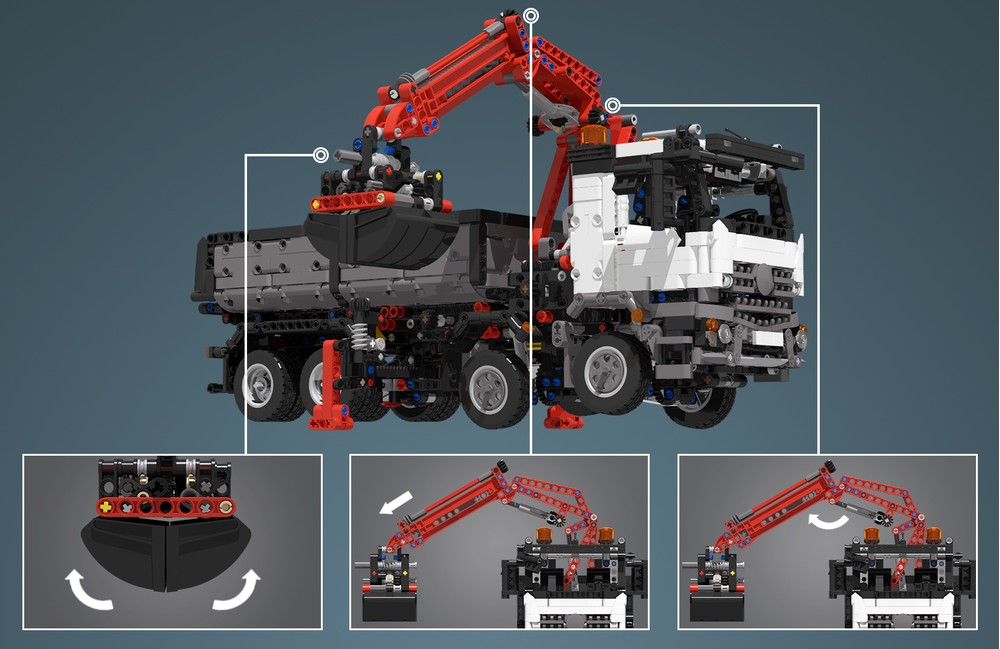

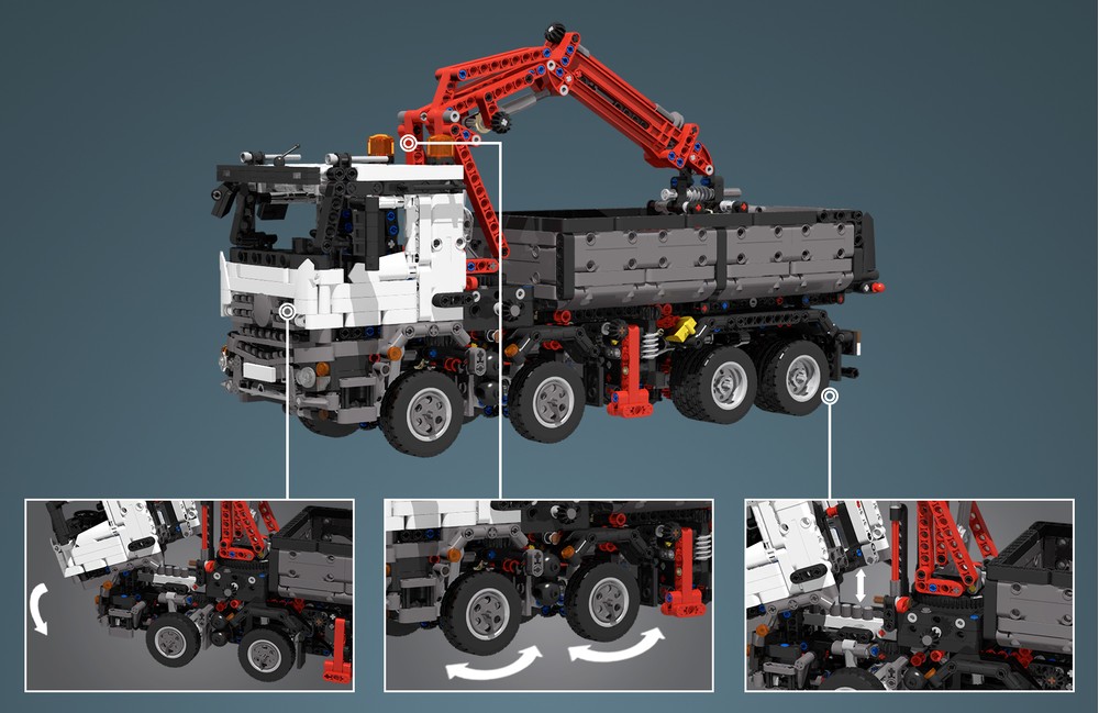

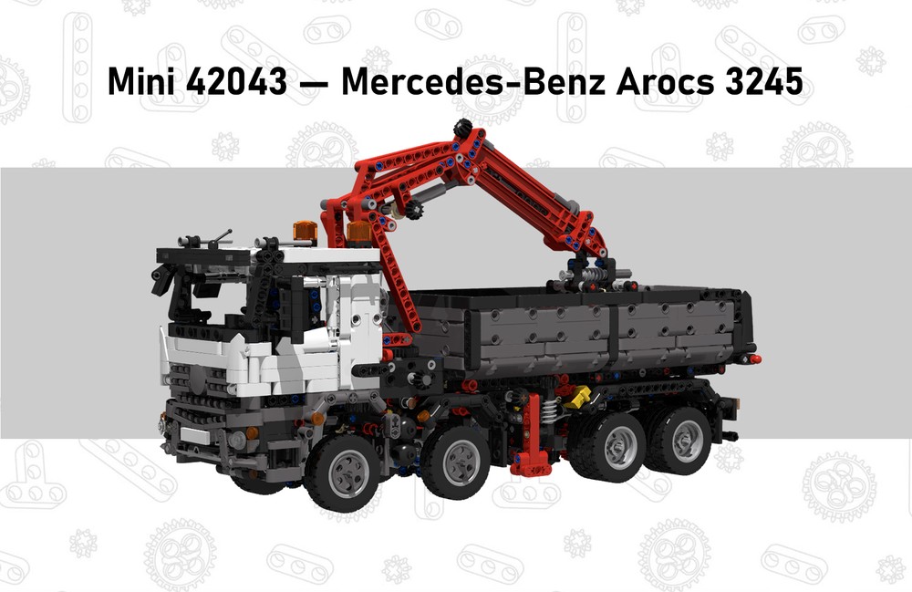

Ngoc Nguyen Posted November 18, 2025 Posted November 18, 2025 2025 marks the 10th year anniversary of the release of 42043, the most iconic Technic set of the modern era of Technic. It is also my 10th year here in Eurobricks. It is no coincidence: I joined this forum because I came across Jim's excellent review of the original 42043. Therefore, nothing is more fitting that doing a mini 42043 to celebrate the occasion. This model is meant to be revealed on August 1st to match the exact date that 42043 was released, but due to delay in custom clearance, the parts to build this didn't arrive until last week, Oh well, better late than never. At least it's still 2025! DEVELOPMENT I know what you're thinking. It's that guy who does the mini replica again, he's probably gonna yap about how difficult the design process was, and how he overcame it, so I'm just gonna scroll through. Well then I'm not gonna bore you with that. I'll go straight up to the interesting parts. THE GRILL The original 42043, highly regarded as it is, still has some aspects that can be improved upon. For me, one of them is the grill. Mercedes-Benz Arocs almost always have 4-slit grills. I'm aware that there are version with 3 slits, but the 4-slit version is more common. So I set out to do that. The bumper has 2 slits, and the cabin has 2 slits, just like the real thing. To achieve the slant in the bottom slit, I have to use some unusual connection techniques. This is how the bumper look from behind. CABIN LOCK Another downside of the original cabin is that there's no firm point to grab it. The crane can move, the bed can move, the cabin can move. Therefore, I added the locks behind the cabin. THE CHASSIS In my previous 4 axle truck, the Iveco T-Way, I managed to put pendular suspensions into the 2nd, 3rd, and 4th axle. I couldn't add that to the 1st axle because of structural constraint. That is the limit that I'm determined to break this time, and I did it. Both front axles are steerable AND have pendular axles. I'm very proud that the chassis can accommodate pendular suspension in 4 axles AND a 6 cylinder inline engine AND steering axles with two different radii AND the outriggers AND a linear actuator for the bed. This is how the chassis looks. CLAMSHELL BUCKET The clamshell buckets are probably designed to be operated with pneumatic. I set myself a challenge: make it work with gears. Does it work? Yes it does! Watch everything in action here: THE END, OR IS IT? Normally, that would be the end of the introduction post. But I think that much wouldn't be enough for me, and it wouldn't be enough for you either. I have done this mini replica thing for a while, and the formula is getting stale. I wanna do something different to break out of the previous boundaries. So I took a look back on the original 42043, and check if there's any other thing about it I can do. Then it hit me. Remember that thing in the back of the box? The thing that used to be a feature of Technic but is no longer since 2024? Yeah this thing. So what did I do? I created a B model too!!!! Please welcome Mini 42043 B - Mercedes-Benz Articulated Construction Truck! You can get both instructions here: https://reb.li/m/240252 Quote

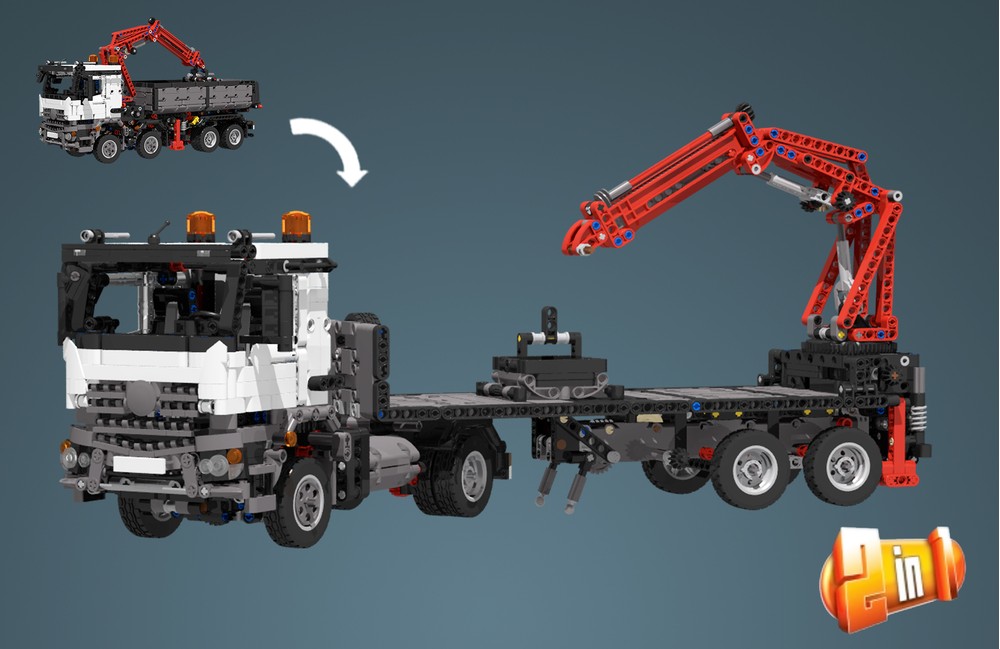

crazy technic Posted November 18, 2025 Posted November 18, 2025 yet another great looking mini model, does your B-model also use the same pieces as the A model? Quote
Ngoc Nguyen Posted November 18, 2025 Author Posted November 18, 2025 2 minutes ago, crazy technic said: yet another great looking mini model, does your B-model also use the same pieces as the A model? Yes it does! It's a proper B model!! Quote

Jundis Posted November 18, 2025 Posted November 18, 2025 This gotta be you best model yet! Perfect shaping and great functions, also implementing the suspension in this medium-sized model, just whoa. Hats off! Quote

1gor Posted November 18, 2025 Posted November 18, 2025 Looking what you made, now I can took 42043 apart for my future project (in bigger scale). So far I didn't have a heart to take it apart, but now I know if I decide to have Arocs, there is better alternative in Volvo 42175 scale. Looks very very good Ngoc. Quote
gyenesvi Posted November 18, 2025 Posted November 18, 2025 This is wild, densely functional and premium with that B model, looks awesome! You do really take this game of minification to the limit! Quote
Paul B Technic Posted November 18, 2025 Posted November 18, 2025 Great work as always and I love that you also made the B model. Quote

Ngoc Nguyen Posted November 19, 2025 Author Posted November 19, 2025 8 hours ago, 1gor said: Looking what you made, now I can took 42043 apart for my future project (in bigger scale). So far I didn't have a heart to take it apart, but now I know if I decide to have Arocs, there is better alternative in Volvo 42175 scale. Looks very very good Ngoc. Thank you! If you don't have any parts you can build the Arocs semi truck in the B model as well. 7 hours ago, gyenesvi said: This is wild, densely functional and premium with that B model, looks awesome! You do really take this game of minification to the limit! As a company says, or used to say, only the best is good enough! 7 hours ago, Paul B Technic said: Great work as always and I love that you also made the B model. Thank you Paul! 5 hours ago, J159753 said: This looks wonderful, as ever – congratulations! (Can I raise a side-issue, though? Imgur is no longer available in the UK, and Imgur-hosted images are not visible on UK computers. Please could posters consider using other image services if it's convenient for them to do so? Thanks! https://help.imgur.com/hc/en-us/articles/41592665292443-Imgur-access-in-the-United-Kingdom) Thank you! You can see the comparisons here. Quote

Ngoc Nguyen Posted November 25, 2025 Author Posted November 25, 2025 On 11/21/2025 at 5:51 AM, Timewhatistime said: If you got some more for us, many of us would appreciate it. Here's another design solution I used in the set. This setup allows compact pendular suspensions in both front axles. To ensure structural integrity, I brace the bottom side with tow ball links that go through the turntables. The links can connect both ends while allows rotation around it because it's thinner than a liftarm. Quote
Ngoc Nguyen Posted November 28, 2025 Author Posted November 28, 2025 On 11/25/2025 at 5:22 PM, Ngoc Nguyen said: I was waiting for someone to point out a drawback of the setup above but haven't seen anything, so Imm spoil it That setup doesnt really allow a drive axle to pass through to drive the inline 6 engine in the front, and that is an actually challenge I had to solve while designing the model. The solution is like this. I used a clutch 20z gear to bypass the steering axle. Also in the front, because of limits space, the first crank is only a thin liftarm. You can also notice that I used a bar connector for the last crank because it's directly above the turntable, so it needs to be shorter. A full length 2 module crank will touch the turntable while spinning and can't do a full revolution. Quote
