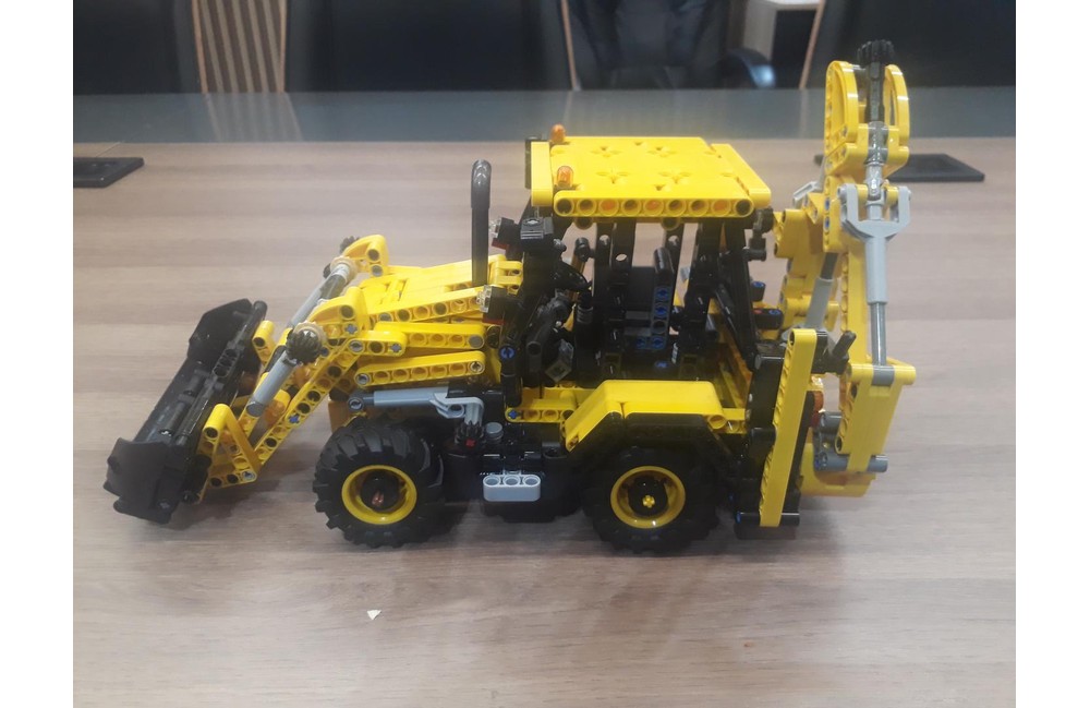

The collective interest in a Technic backhoe has been around since as far as when I first joined this forum, which was 10 years ago. Such intense interest is understandable: a backhoe is one of the most complex, if not the most complex vehicle for a Technic model, since it has a lot of functions while its main body is rather compact. Hence, as I see it, a backhoe is like an apex of Technic or at least Technic construction machines. Yet there are not many official Technic backhoe. Before this year the most recent iterations were 8069, a medium sized backhoe set released in 2011, and 42004, a mini version released in 2013. That means there was a whole interval of 11 years with no new backhoe. Then this year a backhoe appeared in the lineup, but it turned out to be a mini version, an arguably worse iteration even, given that it has less pieces and functions than the 42003. Even though the full 2025 lineup is not revealed, since there's already a mini backhoe, it's unlikely that there will be another medium sized or flagship sized of the same subject. Therefore I decided to publish my own backhoe this year.
DEVELOPMENT
The design process for this model actually started in late 2021. Back then I wanted to build a road construction playset that contains a backhoe, a trailer, and a truck from the Heavy duty Tow Truck 42128. I don't have the file for that model with me anymore, but here's a custom digging bucket I built from 42128 parts.
At that point I already finalized the digging arms. Its design stay unchanged in the final model.
But then for some reasons I lost interest along the way so I stopped working on it.
Then last summer there was a Technic Contest that involves building models around the 49.5 tyre. That was when I took that backhoe out of the freezer and combined it with features from my 42157 alternate model.
Then I encountered two problems. The first problem is that I've always wanted to build the JCB 3CX Compact. It has to be the 3CX Compact and not 3CX or 4CX because the 3CX Compact has 4 small wheels, which allows more space in the body. In real life there are versions of JCB 3CX Compact that use truck tires like the 49.5, but I think it just looks stupid. I want it to have proper tractor tires. The second problem is that I was stuck at the rear wheel arch. In the real vehicle the arch is yellow with a thin black line. I struggled to recreate that in the small scale.
I=
So even though I made quite some progress, I lost interest in the summer and left the model in the freezer again. By that time I got most of the main body done. You can also see an attempt at the wheel arch.
Then in November I happened to open this file again, and I felt that I can finish it. I spent a couple of weeks in November on it to finish the preliminary design, then wait for the parts. When I did the test build, most functions turn out fine, except the front loader arms. There will always be something that looks nice on Studio but doesn't actually work and require a redesign. This is how the prelim looks like. I already revealed it in my Technic corner. You can compare it with the first image to see how the front loader arms have changed.
In the end I managed to make everything work flawlessly!

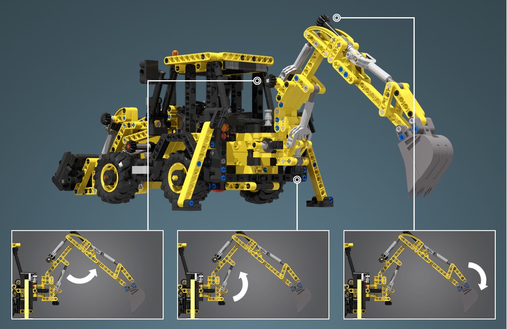

Since it's a small scale backhoe, most functions are directly driven through knobs, so there's nothing fancy in that regard. However there are other nice things I want to share.
Chassis: The whole chassis is nested in side a pair of 3x19 yellow frame. This piece is very usefull as you can form a chassis right away without having to extending it with beams. It is only 5L wide, so I have only 3L in the middle to squeeze 3 functions: drive train, steering, and rotating seat. This is how everything is arranged.
Inline 4-engine: I managed to make everything black while giving the piston heads yellow half bushes, so it looks very cool and luxurious.
Two-piece hood. In the real 3CX, the lid together with side walls can be lifted up separately from the front grill. In my model I made them openable separately too. I managed to put a fan behind the grill as well.
Cabin interior: I managed to replicate some details. In the real cabin there are 3 pedals, two gray ones on the left and one black one on the right. The seat is only rotatable counter clockwise, because there's a control panel on the right side. There are 3 joysticks, and the two in the back are adjustable once you turn the seat around.
Sliding digging arm: This is the function I like the most and want to incorporate into the model at all costs. For a compact backhoe, it's very important that it can slide the digging arm to one side to fold it up stay compact while travelling on the road. The sliding is designed like this. You use a long axle to spin the axle connectors on both sides to move the arm.
Jackhammer and hose reel: On the right side of the model I put a reel, a pneumatic connector, and a jackhammer. If you have a spare pneumatic tube you can connect the jackhammer to the vehicle.

If the backhoe is built like in the digital renders, the two Mini-LAs will work counterwise and so won't operate the bucket.
If it's done as shown in the video, they will.
Shoot you're right... Thanks for pointing that out. I've just updated the instruction. As for the renders they took too much time to do so I'll just leave them there.
