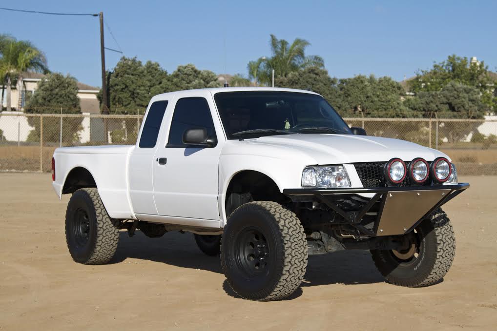

measyn Posted January 19, 2024 Author Posted January 19, 2024 9 hours ago, Aurorasaurus said: Maybe you could add custom stickers to give it a slightly more trophy truck look? This is a great opportunity for personalization, light bars, fire extinguisher, intercoolers in the back. I was constantly watching YT channel WingsWorld and fall in love with the stock look of real 90's white trucks, upgraded in the garage. Quote
