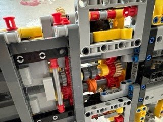

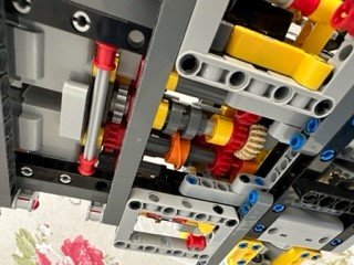

Micky505 Posted September 2, 2023 Posted September 2, 2023 Hi, Ive come here to get some help regarding building the D11. Im at step 198 at the calibration part and guess what, nothing seems to work properly. Ive rebuild the gearbox twice already and ive looked online for common faults but i can't get the damm thing to calibrate. Ive updated firmware, new set of batterys,... Even the motors that spin the wheels wont turn in any direction. Changing the wires on the battery box only gave me fault codes so that shouldnt be it. Can anyone confirm this is what the gearbox should like look? i can't upload bigger pics then 0.1mb so sorry for the quality. Getting really frustrated here, ive built the mercedes Arocs and that was a breeze compared to this. Thanks in advance! Quote
anyUser Posted September 2, 2023 Posted September 2, 2023 Hello, the relative orientation of the orange gear selector and the stop (the orange 2L beam with "o" and "x" hole on the same axle to the right) seem to be OK. Can you verify that the second dark grey shifter that is located "above" / at 90° is in neutral = middle position? First action of the control software is always to activate the gear selecting motor. You should get a short "whining" tone until the end stop is reached. A movement can probably seen if the gearbox is viewed from the angle shown in the photos. I assume that you have verified that the two motors of this gearbox (selector and drive) are connected to theier corresponding ports? Quote

anyUser Posted September 2, 2023 Posted September 2, 2023 (edited) (There is a strict size limit for uploading pictures to Eurobricks. However, you can upload bigger photos elsewhere and paste a link into your posting.) I just checked the calibration sequence: first action is on the gear selector. If this can be set to the expected position the drive motor (= constant rotation) is activated. I assume you don't get this far? Edited September 2, 2023 by anyUser Quote

anyUser Posted September 2, 2023 Posted September 2, 2023 OK - you are doing the installation check, not the calibration (which will determine the end-stop on the actuators). I tried to compare with my bulldozer with is fully build build and therefore difficult to observe. For both the "cogwheel" and the "gearbox" test first the gear selection motor is activated. After some (short) time the second motor will also be started. There are some small back-and-forth rotation before it is activated for longer time. From your videos I can recognize: - The gear selector is running longer time than with my setup - There seems to be no action from the second = drive motor You should check: (If the motor is not recognised "found" the app should report at the beginning) - Could it be that the calbles of the two motors for the functions are swapped over at the battery box? - Is it possible that a 'drive' gear is actually connected to the gear selector? I don't have any more advice for now. Quote
