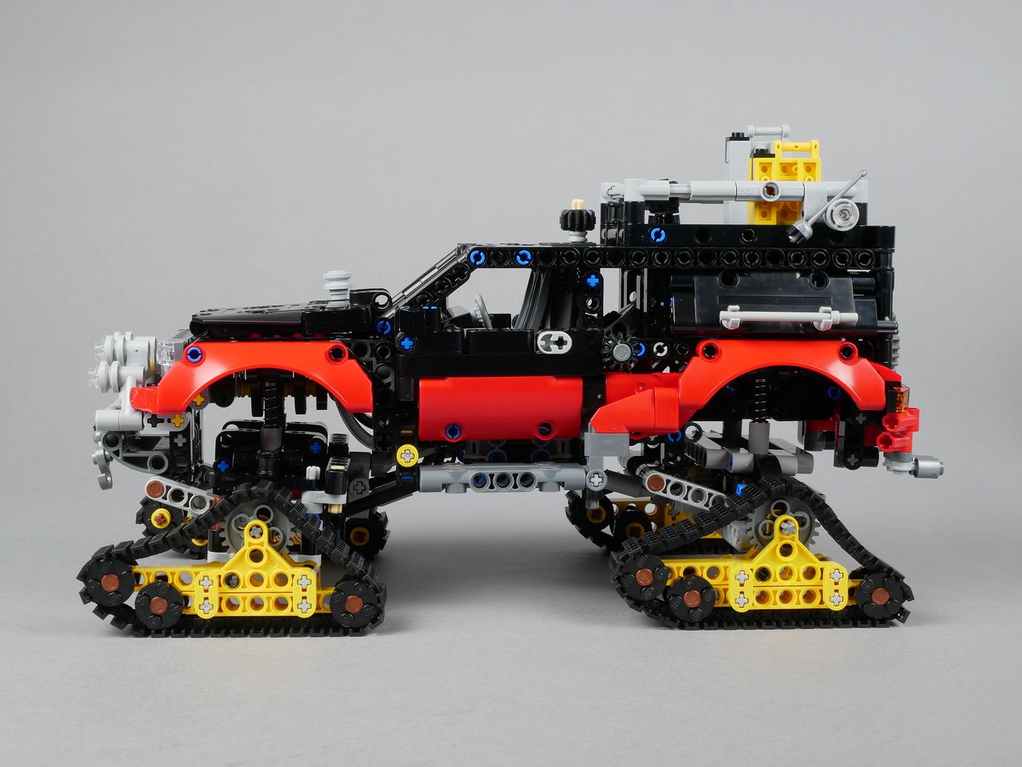

Ngoc Nguyen Posted May 7, 2024 Posted May 7, 2024 User seregiz built this model with red and it looks ABSOLUTELY fire!!! Quote

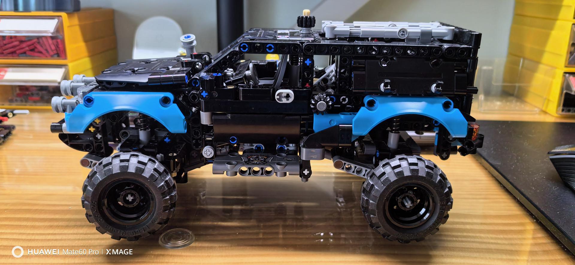

Ngoc Nguyen Posted September 26, 2024 Posted September 26, 2024 Finally got some time to build this model in real life according to the instruction I made. I went back to fix some errors and made some changes to make the building experience easier. I also made two major redesigns. The first redesign is the removal of the shock absorbers for the door. The role of the shock absorbers is to create a bistable mechanism. However, the current linkages already guarantee that, as I discovered in the real build. The removal of the shock absorbers also makes it easier to close the doors. The second change is the angle at which the front links connect to the door. In the original version, when the upper parts of the doors are opened, the links bend too much outward from the tow balls, and sometimes they just detach from the tow balls. Therefore I changed the angle of the tow balls to make the connections more secure. New instruction and new part list have been updated on Rebrickable. Quote
