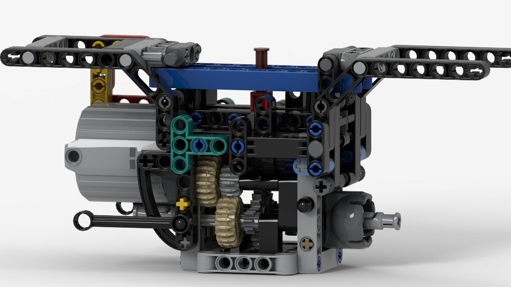

Yes, it is. Actually i'am working on a leafspring chassis for my Scania cab. Coil springs struggles a little bit with the weigth. Maybe the leaf springs are the solution for this problem, but the axle construction has to be quite different with this type of mounting points. I really would prefer the mounting points of my design.

Also, the axle mounting point does not seem to leave too much room for axle articulation. Or is there enough space for a cross beam to tilt under it?
sorry, i dont understand.
with my design an axle is pretty simple.
The cada mounting points are making it a little bit more complex. please ignore the driven steering. the concept is still the same when it is not driven. there is still a connection neccessary to the liftarm between the wheels. my solution sticks simply in the liftarm, the cada mountig needs an perpendicular hole to the liftarm.
Edited by efferman
Thanks for the great illustrative images!
Indeed, that's simpler than I thought, at least for this case when there is no drivetrain (though I assume that a drive axle can run through the leaf springs in the middle). I like that the leaf spring is positioned quite low with this design, it would even leave room for a linkage based steering on the top!
But I am more interested in the driven scenario in your second image. I imagined it exactly like that, my question is that when the axle articulates, it has to tilt relative to the leaf spring itself, which remains stationary in the chassis. Is there room for that tilt under the leaf spring? Or is it mostly just distorting a bit within the tolerances of the pieces? Although typically vehicles with leaf spring suspension don't need that much articulation, in some cases it would be handy :) In case of your design, only minimal tilt is possible because of the vertical pins, mostly a bit of distortion, right?
Also, I wonder how your design would be incorporated into the second driven axle? I'm sure you tried that..
Edited by gyenesvi
Surprisingly not.
Well, a simple beam has space to tilt, a perpendicular beam has no space. The the leafs have to flex by themself.
Yes, that was my question, thanks. Better than nothing, though it would be nicer if the perpendicular one was also usable; a bit more space under it would be appreciated. Maybe in the next softer version :) I guess this part is already finalized and produced.

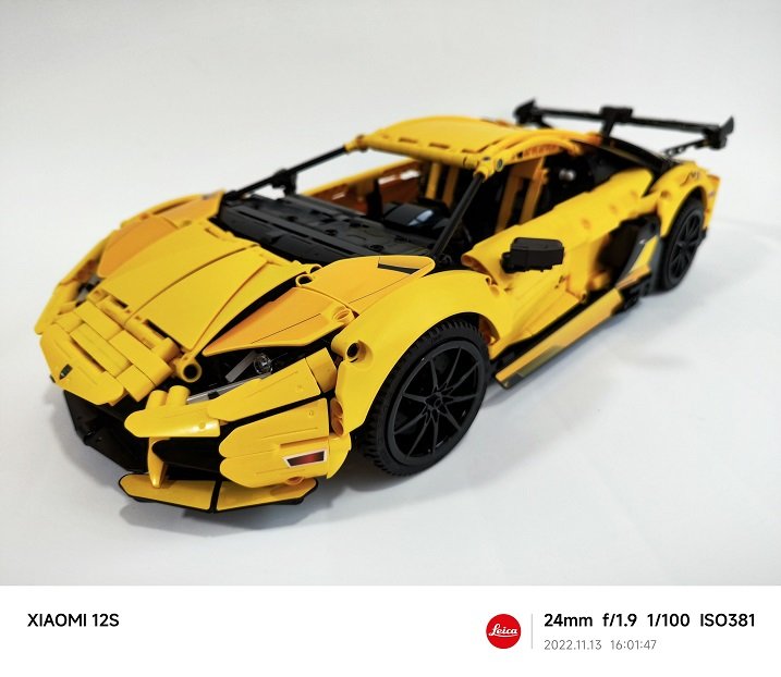

Hello, i have CADA C61008w and considering to change the L with Xl motor, L motor is not enough torque power i think.
i'l manage to draw simulation in studio 2.0 but but the to change the motor i must buy Mouldking set (XL motor,Servo ,Batterybox, Tx) around us$50, does it worth it ? and change from L to Xl motor is it realy bump up the crawl performance ?
Thank you.
https://drive.google.com/file/d/13-0r60J2lV_87rJYFZr3BRKNNwVUg7P9/view?usp=share_link
24 minutes ago, efferman said:
Hm, i guess the crawler has enough torque. It is more limited by to hard shocks.
 the hard shocks also a problem, oftenly tip over on bad camber track since the suspension config itself not macpherson. i will record & share the video tonight hopefully you can help analyze the problem. many thanks
