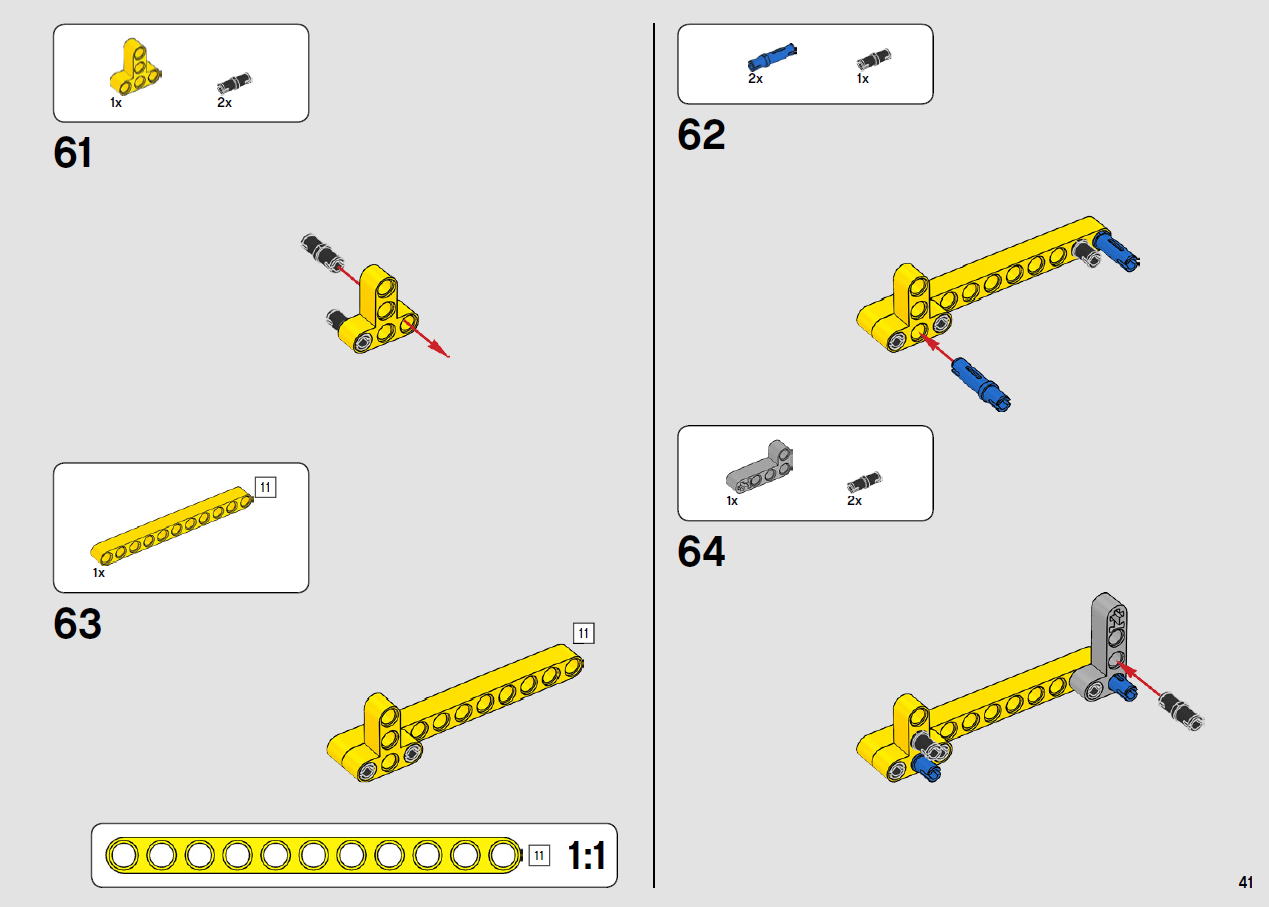

kbalage Posted August 13, 2020 Posted August 13, 2020 2 minutes ago, JaBaCaDaBra said: Did anyone notice that LEGO removed the instructions from their website? Probably to quickly fix page 41 :)Â Quote
mpj Posted August 13, 2020 Posted August 13, 2020 (edited) On 8/8/2020 at 7:57 PM, Coolusername said: Post your 42114 mods here. Does someone has a fix for the "hanging head" aka weak pivot joint for the front section of the truck? I did this: added 2x 1x3 thin liftarms and replaced frictionless pins with the black ones 7 minutes ago, kbalage said: Probably to quickly fix page 41 :)Â What is/was wrong in this page? Edit: sorry just noticed! Edited August 13, 2020 by mpj Quote
JaBaCaDaBra Posted August 13, 2020 Posted August 13, 2020 2 minutes ago, mpj said: I did this: added 2x 1x3 thin liftarms and replaced frictionless pins with the black ones What is/was wrong in this page? numbers at wrong place 62 and 63 should be interchanged Ha just got mine working it didn't calibrate, made the most terrible clicking noises... studied the gears for hours and just found that I stuck the drive axle next to the axle connector at the joint between front and read. $^%$^&*^()* Â Quote
