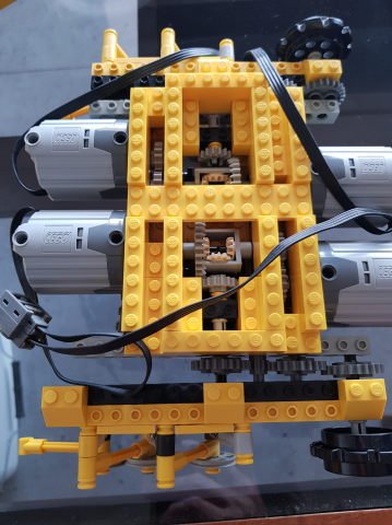

gilboa Posted April 18, 2020 Posted April 18, 2020 (edited) Hello, Hopefully I'm not breaking any forum rules but posing the following questions (In my defense, I'm double checked where this should be posted). Long story short: I'm rebuilding my MOC (yellow) tank, this time with 4 x XL engines, as the previous setup (2 x XL) was too slow to power this beast (I want it to be *big*), with each two XL engines connected to a differential (see picture(s) below) and to one edge of a PF V2 receiver. Currently I'm facing two issues: 1. The 90 degree non-beveled gear (cog) between the differential and the external gears seems to slip under load. Most likely I'm using the wrong part. Any idea which part I should use? AFAIR the differential P/N is 73071. 2. As noted above, I've got 2 x 2 x XL engines connected to the PF V2 receiver. Under load, it seems to cut off. Am I tripping the over-heating and/or over-current protection? Any possible solution, beyond buying SBrick / BuWizz? 2a. Assume the answer above is a resounding *Yes*. Any suggestions? Will both will be powerful enough to power 4 x XL engines + ~2-3 XL/L engines (for turret, gun elevation, etc)? Thanks! 4 x XL power pack: https://imgur.com/a/EiVx6MB Edited April 18, 2020 by gilboa Quote
Gray Gear Posted April 18, 2020 Posted April 18, 2020 What is the point of putting a diff between the motors? I would recommend to just dive the front and rear sprocket wheel with 1 Motor each Quote
romashkaman Posted April 18, 2020 Posted April 18, 2020 Every motor has slightly different rpms with the same voltage. It's better to put diff between motors, but I don't do it too) Quote
gilboa Posted April 18, 2020 Author Posted April 18, 2020 Just now, Gray Gear said: What is the point of putting a diff between the motors? I would recommend to just dive the front and rear sprocket wheel with 1 Motor each The previous tank iteration had one XL engine on each side, and it simply didn't have sufficient power to move it fast enough (to my liking). As for the differential, as romashkaman said, as far as I know, not all XL engine are created equal, minute RPM differences can shorten their life considerably when combined in a direct drive. Quote

Nazgarot Posted April 18, 2020 Posted April 18, 2020 (edited) I would suggest making a drive train where all four motors are direct coupled and delivering drive through a adder/subtracter gearbox. motors being direct coupled is not a problem. It's only at no load situations they have a significant speed difference, and under high load they will all be using their power to move the thank rather than fighting each other. No motor moving a heavy model like this will ever reach it's top RPM, so the extra heat generated by direct coupling them will be negligible. Take this from a electronics engineer... I've done this for tank iterations I've made, and it removes any problem with motors running the belts at different speed, as well as giving much better control. It does however require a fifth motor for steering. You will quickly find that a traditional diff can't handle the load of two or in my case four motors. I designed a diff around the large turntable to solve this problem. See pictures below. I'm currently using this design with two buggy motors on a ripsaw based moc I'm working on, so it should be more than strong enough. Just be very careful with the gear placement as it is easily possible to get one or more of the planetary gears out of alignment when you close up the diff. It should have no undue resistance when you test it. I know this solution requires a lot of space, but on a tank of this scale it should be no problem. Design for placement of the diffs can be a bit hard, but I suggest placing them vertical to the tracks so that you can have a up gearing after them to the drive sprockets. This solution can be a bit hard when it comes to delivering power into the diffs as right angles in a drivetrain with 4 XL motors is always going to be a weak point. But if you can solve that you should have a very powerful drivetrain that gives you a very gradual control and a lot of power to the tracks. -ED- Edit: Sorry. The pictures above is a old design with a fatal flaw. It's almost impossible to dismantle... The picture below shows the evolution I've had on this design, and the leftmost design is one of the newest and solves this problem as well as using fewer parts. the internals are still the same though... And the following picture shoves the same design in real life. I've made one more iteration on who the turntable is connected but have no pictures available. Edited April 18, 2020 by Nazgarot Wrong pictures... Quote

Saberwing40k Posted April 22, 2020 Posted April 22, 2020 On 4/18/2020 at 11:43 AM, gilboa said: Currently I'm facing two issues: 1. The 90 degree non-beveled gear (cog) between the differential and the external gears seems to slip under load. Most likely I'm using the wrong part. Any idea which part I should use? AFAIR the differential P/N is 73071. 2. As noted above, I've got 2 x 2 x XL engines connected to the PF V2 receiver. Under load, it seems to cut off. Am I tripping the over-heating and/or over-current protection? Any possible solution, beyond buying SBrick / BuWizz? 2a. Assume the answer above is a resounding *Yes*. Any suggestions? Will both will be powerful enough to power 4 x XL engines + ~2-3 XL/L engines (for turret, gun elevation, etc)? 1. Old 28z differentials are not meant to be used with 16z gears, so slipping is to be expected. I'd eliminate this entirely. 2. Yes, you are. My solution would be to use either separate receivers and battery boxes, or servo controlled switches. Buwizz or Sbrick would be helpful, but are not requirements. 2b. Since the tank is so large, I'd use a separate battery box for the turret. When I built a large tank, I need a battery box to counter balance the main gun. Now, for a large model like this, I would not use differentials in an adder configuration at all. This does not really solve any sort of real problems, and indeed introduces many new ones. I'd also do some gearing down to the XL motors. I think one problem you might be having is the fact that you don't have enough torque, and that is one reason your model was slow, the motors were overworked. Also, I'd be wary of doing anything with clutches and brakes. That, again just introduces complexity for no real gain. I'd just steer by stopping one or the other motors, like 8275 does. Now, if you were feeling fancy, you could go for a subtractor, but I have found that sometimes in a subtractor setup, you lose a lot of power because the differentials backdrive the steering motor instead of driving the vehicle forwards. Also, these notes can be helpful:http://www.gizmology.net/tracked.htm Quote
Tarix819 Posted April 22, 2020 Posted April 22, 2020 (edited) I built a tank which weighs 6 kilograms and is only driven by two XL motors. Not sure if your vehicle will be smaller or larger but using differentials, especially old 28-tooth differentials is a no-no for heavy Lego tanks because they slip under high torque. The effect of a subtractor can be achieved by using a Lego Train remote control or an SBrick/BuWizz. Edited April 22, 2020 by Tarix819 Quote
Andman Posted April 22, 2020 Posted April 22, 2020 On 4/18/2020 at 8:10 PM, romashkaman said: Every motor has slightly different rpms with the same voltage. It's better to put diff between motors, but I don't do it too) The difference is so small, if you are using the same type of motor. It's not worth it, since you add more friction with additional gears and axles for the diff. Did you test it before? did you connect two of the xl motors to a diff? Did diff turn a lot in one direction? In my tests it never did. So I discarded my plans to couple motors with diffs. Quote
Zerobricks Posted April 22, 2020 Posted April 22, 2020 There is no advantage of using diffs to couple motors. Technically speaking 9398, 41999 and 42099 have hard coupled drive motors too, with each being on their axles, yet coupled via ground and wheels. With such big and heavy projects keep it as simple as possible. Have every motor drive the tracks in front and rear with minimum amount of gears as possible. Quote

howitzer Posted April 25, 2020 Posted April 25, 2020 23 hours ago, gilboa said: <snip> 1, What type of gear should be used with 28z? (I couldn't find a definite answer) <snip> The old 28-toothed differential uses 14 tooth bevel gears. They are very weak and where phased out in the mid-90's in favor of the reinforced 12-tooth bevel gears. https://www.bricklink.com/v2/catalog/catalogitem.page?P=4143 Quote
gilboa Posted May 3, 2020 Author Posted May 3, 2020 (edited) Hello all, Tried going with the far simpler setup - read: I dropped the differential and and switched to two XL engines (connected directly) / v1 receiver / battery box on each side, and at least for now, it seems to work just fine. I'll update if the XL engines go up in flames... :/ Thanks all. Edited May 3, 2020 by gilboa Quote
