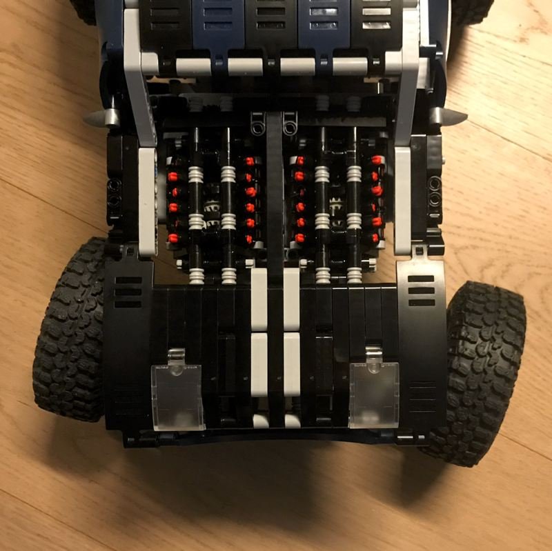

  • Has 2 working fake V8 engines

I removed the wheels and rear fairings, so you can see how the rear suspension works:
Land rover rims can only be placed on brick-built hubs, which are weaker than normal planetary hubs. That is why they are used only in front.

I don't understand, on the rear axles there is a link with a shock absorber between the axle 2 and the axle 3, but there is not a pin to attach the middle of the link on the body ? Where is the little axle on which the link swing ?
Edited by LegoTT
Typo
Both 6L A arms can swing up and down. Try building a mock-up and you will see how it works.
