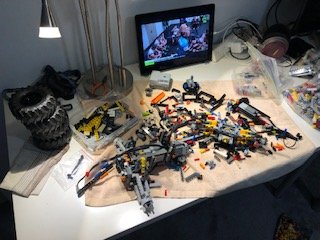

Next step in Chassis changes to allow to move the batterybox more forward.  Bricksafe for bigger pictures
Edited by efferman
Unfortunately after checking this model has no cross block/form (LDD name) pieces, I don't know why I thought it had some and since 8 are required for the new suspension its not possible to do with the parts in the box. However these 8 pieces are all you need (I made double sure this time) but even so its still more of a c model than an upgrade to the a model so sorry for posting in the wrong topic. However you can eliminate the diffs with this method.

I’ve been modding mine, loosely based on efferman’s, I am using the 9.5L shock absorbers, doing Aerlight’s locked diffs, longer swing arms.
I've got the rear end done, working on the front end, but struggling with the steering, could you please show more details of your steering mods @efferman?
A lxf will come
