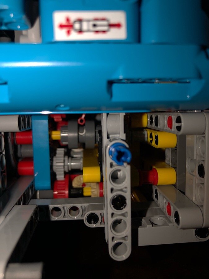

Idris Posted April 23, 2019 Posted April 23, 2019 Hi Everyone, My problem is that the 42070 tow truck does EVERYTHING, except going backwards and forwards and the cylinder movements. The crane works in everyway, the front wheels move left and right, the “legs” work, without power, the truck moves perfectly, but it does not move backwards and forewards with the motor, only. After assembly, I am left with a red cogwheel ( code 6100930 ) and a small yellow one ( code 4565452 ). Of course I am sure I did something wrong but where do you think I did it? By the way, the large motor is only connected with a yellow shaft just after connection until the first grey differential discs. So there is no connection with the upper part (going to the cylinders and mill) and the main system below. I disassembled partly and put a grey cogwheel in between but it only moved the cylinders ( then I saw it was needed afterwards). So could you kindly please help me solve this cogwheel issue by providing some images, videos, references, drawings? Thank you in advance and, Best Regards, Idris Quote

Idris Posted April 23, 2019 Posted April 23, 2019 12 minutes ago, Zerobricks said: Sound like you forgot to install the gear for driving the wheels. It should be one gear above the central differential, right on the XL motor drive axle. Many thanks for answering me, let me kindly send you a photo and kindly please tell me what you think Quote
suffocation Posted April 24, 2019 Posted April 24, 2019 (edited) Yup, definitely missing a red 16T gear there on the left of the dark bluish gray changeover catch, as well as a tan half-bevel 12T gear in the red differential casing. Edited April 24, 2019 by suffocation Quote
Idris Posted April 24, 2019 Posted April 24, 2019 3 hours ago, suffocation said: Yup, definitely missing a red 16T gear there on the left of the dark bluish gray changeover catch, as well as a tan half-bevel 12T gear in the red differential casing. Many many thanks on your reply, I’ll put the red gear, however the red differential casing doesn’t look to “firm” a third gear.. Did I mis-install or uncorrectly install the red differential casing? Best Regards, Idris Quote
1gor Posted April 24, 2019 Posted April 24, 2019 (edited) New red differential and new red gear 16t with clutch do not work together so well as dark bluish gray combination due to symmetrical design of red gear with 16 tooth... Edited April 24, 2019 by I_Igor Quote
suffocation Posted April 24, 2019 Posted April 24, 2019 4 hours ago, Idris said: [...] however the red differential casing doesn’t look to “firm” a third gear [...] The differential should look something like this (ignore the different colours) once all three half-bevel gears have been slotted in: Quote
Idris Posted April 24, 2019 Posted April 24, 2019 9 hours ago, suffocation said: The differential should look something like this (ignore the different colours) once all three half-bevel gears have been slotted in: Dear suffocation, yes, I know this image, however the red differential does not have any place to place a third gear inside, please have a look: Just now, Idris said: Dear suffocation, yes, I know this image, however the red differential does not have any place to place a third gear inside, please have a look: I take my word back, I just saw the place! Sorry! :) Quote
