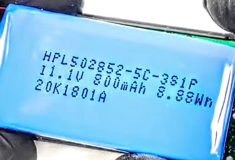

Ryokeen Posted October 12, 2023 Posted October 12, 2023 Somewhere earlier in the thread, someone posted a pic of the used battery a HPL502852-5C-3S1P 800mAh. Just had a quick look at it and i would assume, that running 2 buggys or simply drawing that much current is just to much for the bat. It as a fast discharge rating of 5C. From what i know that would mean with 800mAh it can max deliver 4amps in total. Save a bit for the board it's easy to get above that. But yes it would be better to either lower the current before a shutdown happens or only shut down the port drawing to much. Quote

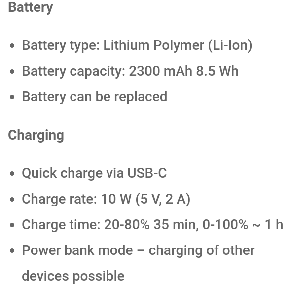

dustblue Posted October 12, 2023 Posted October 12, 2023 (edited) On 11/23/2021 at 9:08 PM, Danil said: I was interested in the following aspect regarding the Buwizz 3.0 battery - the manufacturer's website states that the battery capacity is 2300mA / h and that the battery is replaceable. on the Sariel video, when parsing, it is clearly visible that the HPL 502852-5C-381P element is used at 11.1V 800mA / h 8.88Wh-where is the truth? and second, if the battery is replaceable, what batteries and with what characteristics can be used in this device? It would also be interesting to know whether the battery charge controller is built into the bank or is it soldered on the motherboard? Thank you in advance for your feedback! Expand I also found this: https://p.globalsources.com/IMAGES/PDT/SPEC/679/K1180913679.pdf In this doc it stated a 0.5C discharge rate(normal use), even 5c is really small, in RC 60C even 100C battery is very normal, why would buwizz team use such an inferior battery?? 5C 800mAh 3.7 LiPo battery is like 1 USD each in bulk, this is unbelievable.... Edit: on specs it says minimal current protection is 7A, max 13A, so buwizz doesn't have to set the max for port A&B to be 3.5A, it can be doubled, say 6A would be much better. Edited October 12, 2023 by dustblue add Quote

DKTechnik Posted October 20, 2023 Posted October 20, 2023 Did someone open Mould King 6.0 power module to see battery? On 10/12/2023 at 3:23 PM, dustblue said: I also found this: https://p.globalsources.com/IMAGES/PDT/SPEC/679/K1180913679.pdf In this doc it stated a 0.5C discharge rate(normal use), even 5c is really small, in RC 60C even 100C battery is very normal, why would buwizz team use such an inferior battery?? 5C 800mAh 3.7 LiPo battery is like 1 USD each in bulk, this is unbelievable.... Edit: on specs it says minimal current protection is 7A, max 13A, so buwizz doesn't have to set the max for port A&B to be 3.5A, it can be doubled, say 6A would be much better. Expand Did someone open Mould King 6.0 power module to see battery? Quote
