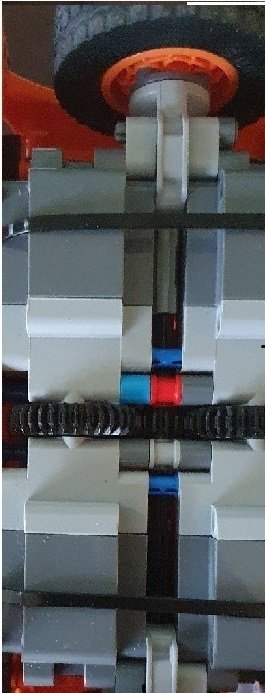

frechettemj Posted July 21, 2021 Posted July 21, 2021 (edited) Buwizz 3.0 in the superstructure and a Control + in the base. 20210720_221201 Edited July 21, 2021 by frechettemj Quote
