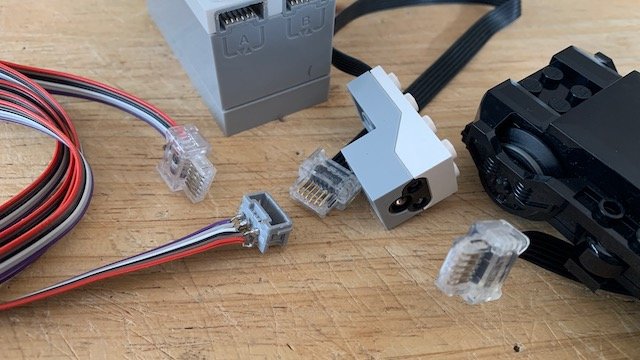

  1. On the basis of a post I ordered the parts from AliExpress to make a Powered Up Extension Cable. I would like some advice. The photo shows my best efforts. When I plug in the light sensor - it lights up ( but I did not test beyond this) The train motor does not run. Without a crimping tool and rather basic soldering iron I was able to make a cable. I have tried to test the voltage and all seems OK, but I must admit I don’t really know what values I should be getting. I would also seek some advice on how to test the voltage values of the pins. I’ve used computer ribbon cable, is this OK? The extension cable that I made is about 100cm, it this too long? The size of the male plug from AliExpress had to be trimmed and reduced in size to fit into the LEGO HUB. I’m absolutely stumped. Any advice would be gratefully received.
