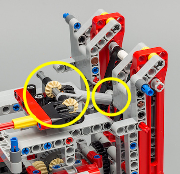

  2. Hello, I just finished assembling the set. However, when lowering / raising the outriggers, I notice that they are not deploying at the same speed. The rear one moving faster than the lateral ones. Consequently, it reaches its low and high positions quicker and stops while the two others are still moving. I can then hear a distinctive "clicking sound" of the rear gear set since the axis is still rotating to fully deploy the lateral pieces. It does sound that it is forcing on the gear teeth and make them "skip". Is this normal? If not, any clue on possible assembly mistake or workaround? Thank you for the feedback!
