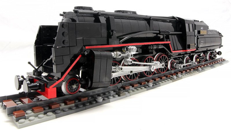

  5. Hi again! I got the side rods to work as I wanted, and the motorization as well, kind of... During the first event I was on this weekend the motors got really warm after an hour of operation and it actually stopped and wouldn't go anymore. After some time it started up again. When I got home I started to think about the gearing at the motors. I currently have this configuration (with more parts holding it together of course): Thanks to Sariel's excellent Lego Gear Ratio Calculator it seems this produces the following output: The theoretical output speed will be 346.7 RPM at 7V and 453.4 RPM at 9V. The theoretical output torque will be 3.89 N.cm. But is there anything that would prevent me from swapping the gears here? If I understand Sariel's calculator correctly this will give me the following output: The theoretical output speed will be 124.8 RPM at 7V and 163.2 RPM at 9V. The theoretical output torque will be 10.8 N.cm. Could this cause less stress on my motors? I understand the engine will go slower, but that's no problem.

  12. For about three and a halv years ago I started thinking about a model of Dovregubben (the name translates to Mountain King and is named after a troll that rules over Dovre in Henrik Ibsen's Peer Gynt). Dovregubben was the last (and biggest) steam locomotive on the Dovre Railway in Norway. In english the locomotive also goes under the name "The Dovre Giant". Now the model is finished in 1:45 scale. This meens a model on about 49,5cm long, 7cm wide and 9,66cm high. The model consist of about 1.200 parts. It is motorized with two PF L-motors that is inside the boiler. It uses a sBrick (which also sits in the boiler), while the battery box is placed in the tender. It's been a fun and educational build! Here are some pictures, there are more pictures on Flickr if you want to see details:
