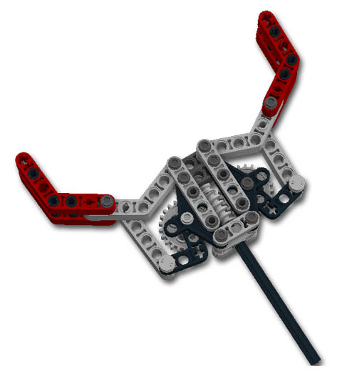

Thanks for the advice! The grabber shown above was just our LDD of it. When we made it we left the bevelled gears out, so that linkage will not be included. It will be directly driven straight to the worm gear from the motor as we don't need to change the direction of the rotation anymore. Does the light grey pulley ever slip when under load? -

The worm gear does substantially reduce the effort required to open and close these grabbers... and it looks like it can be driven backwards and forwards. The link Dluders provided mentions these micro-motors tend to jam up. Have people found this to be an issue? I could rig up some technic connectors to prevent the pulley from coming off too. Some accounts I've read also mention stacking these micro-motors. I guess that would be to distribute the load between them so they aren't working so hard??? -

Thanks Dluders! Do you think the 2986 would have enough power to open and close this grabber, grab a 16g soda can and hold it (the grips on the jaws should do that just by friction) while it was being lifted by a LA? I am liking the look of this little motor because, whilst it is really slow, it is has very little size and weight. -

Ramacco's grabber is a simpler, much better, design and is lighter on the lift-mechanism. We've made a similar one now and are trying to work out how to attach it to a lifter of some kind: (click for full size. Full LDD here). I'm kind of stuck on how to attach the motor to the grabber and have resorted to buying a small power functions motor to install directly onto the top of the grabber so that the flexible cable can go up and down with the grabber. Is there a better way to power the grabber so I don't have to install it directly onto the top of the grabber? We used 6M cross-axles at the front so we can add ultrasonic sensors and/or touch sensors to the grabber.

Thanks to the posts on this forum I have modified a simple grabber that I want to put onto an NXT line follower robot to grab a soda can (I still need to play with the design to put rubber grips on the inside of the jaws and try to fit a touch sensor in so it knows when it has shut around it). Once it grabs the soda can it needs to lift it approx. 10cm off the ground, locate a red block, move to the red block and sit the soda can down onto the red block. I'm wondering if this grabber can be incorporated into a forklift-like mechanism so it can be lifted vertically without tilting the soda can backwards. I was thinking it would make setting the soda can down on top of the block smoother and more precise than something that lifted it up and down in an arc. If anyone has any good ideas I'd love to hear them. Thanks in Advance, Simon
