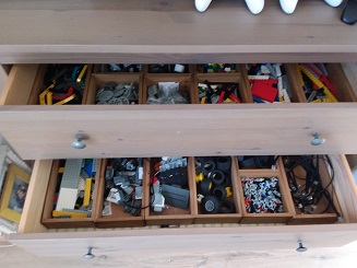

  8. Here my workplace, just wood boxes which I can remove independantly...
