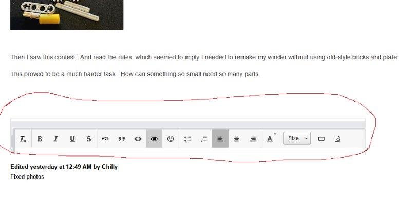

  10. I am in awe of all MOCers Are there any admins that can remove this circled picture? I've tried many times, it just won't go away.
