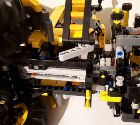

  11. Thank you! For 2024 Volvo I would bet on forest equipment, L180HL - we have already suitable parts for grabber thanks to John Deere Skidder, the only challenge I see is to fit drive for 4 functions (2 pairs of LAs, grabbing and rotating the grabber) in the front part. Vertically oriented wheel hubs are also result of limited number of parts - in such configuration it was possible to lock the hubs using and beams which were part of the front frame and avoid using separate 7L beams for this purpose, as in original ZEUX. I started working on this MOC in... 2021 :). But after designing digging arm, engine cover and cabin I couldn't move on to make it look proportional and I abandoned the project. I returned to building it in April this year, and it took me about 45 evenings to finish it (based on number of saved Stud.io files). 1L worm gear is misleading, as it does not drive anything, it's there only to ensure proper spacing of the gears on the axle :). Here is the photo of articulation mechanism, however it is hard to find good angle to picture it...
