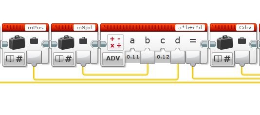

On a whim, I decided to try GyroBoy on carpet instead of a smooth floor to see if the added resistance helped with balance--it did. So, at least I knew it could work. I started playing with some of the variables that affect power, or both speed and drive in the parlance of the program, and found that changing a multiplicand of speed from 0.08 to 0.11 in the EQ block allowed the robot to balance on a smooth surface without falling down. It's the "a" variable in the attached image. I'm making progress... -
