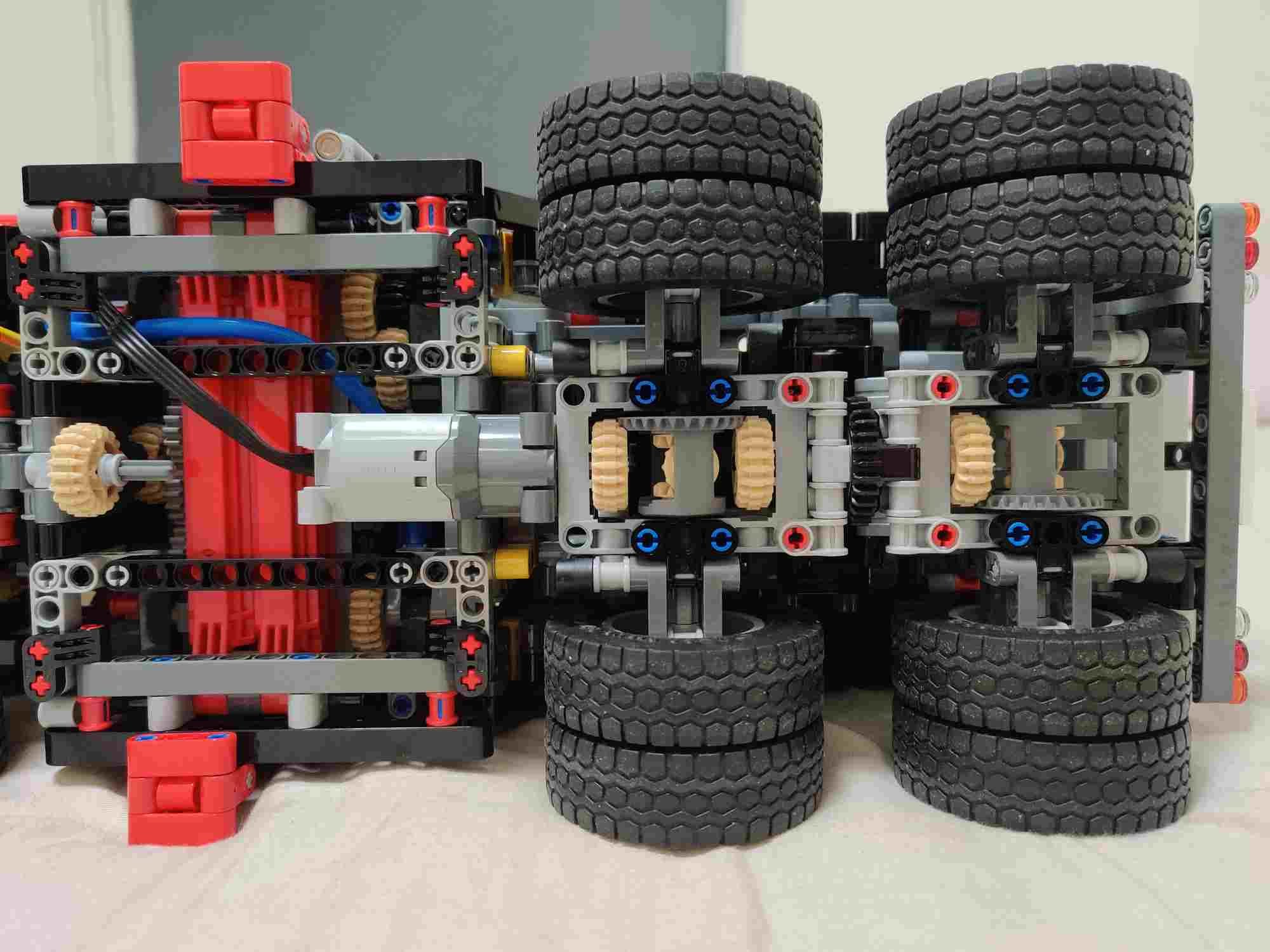

  7. @Jundis@amorti Thanks for the welcome and prompt replies! Hmmm, I did think of gearing down, but I was hoping to achieve the same speed as the videos I referred to. How is it that it worked fine for them and not for me? I'm pretty sure we all used the same steps... I guess it could really be down to the construction of the rear differential and axles?
