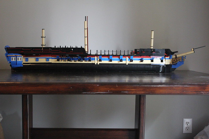

Hello! I'm excited to share my nearly complete MOC of HMS Diana, a fifth-rate Artois class frigate launched in 1794. I set out to make this ship as close to true minifigure scale as I could get it, and I am pleased with the result. I also wanted to improve on the design of my previous frigate in terms of achieving greater accuracy and detail. IMG_1171 by Andrew Cardy, on Flickr The ship took me over a year to design and build, which included lots of time reading up on rigging. I'll include a list of the books I read at the end of this post in case anyone is interested. I re-designed several aspects of the ship multiple times. IMG_1168 by Andrew Cardy, on Flickr IMG_1202 by Andrew Cardy, on Flickr The ship is built with 100% LEGO elements, including all of the rigging. When I began working on it I intended to make the masts and rigging the same way I did with my first frigate, but I soon realized that I could improve on that design and make it more accurate, albeit with far more pieces and many more LEGO strings. All of the standing rigging (the lines which support the masts) is included, as well as some of the running rigging. All of the spars are supported with a series of ropes, just as they would be on a real ship. The spars can all be lowered and raised using the rigging, in these photos the spars are in the raised position, where they would be when the sails were set. IMG_1161 by Andrew Cardy, on Flickr The ship is 45 inches tall at the mainmast, and 46 inches long when measured from the beakhead to the taffrail. It is 65 inches from the tip of the bowsprit to the tip of the driver boom. IMG_1166 by Andrew Cardy, on Flickr IMG_1197 by Andrew Cardy, on Flickr Click the album for more detailed pictures, it was difficult to get some decent shots with the entire ship in frame but I did my best! Some books I read: Mondfeld, Wolfram zu. Historic Ship Models. New York: Sterling Publishing Company Incorporated, 1977. Ball, Nick, and Simon Stephens. Navy Board Ship Models. Barnsley: Seaforth Publishing, 2018. Petersson, Lennarth. Rigging Period Ship Models: A Step-by-Step Guide to the Intricacies of Square-Rig. London: Chatham Publishing, 2000. Lavery, Brian. The Arming and Fitting of English Ships of War: 1600-1815, n.d. Anderson, R.C. The Rigging of Ships in the Days of the Spritsail Topmast, 1600-1720. New York: Dover Publishing Inc., 1994. Lavery, Brian. The Ship of the Line: A History in Ship Models. Barnsley: Seaforth Publishing, 2014. I also used the Anatomy of the Ship series extensively, especially the one about HMS Diana of course, but also several of the other entries in that series. I hope you all enjoy the model and let me know what you think of it!

I think you should consider making the masts taller, from these pictures it looks like they'll be fairly short compared to the length and overall size of the ship. If you're going for a more accurate look the mainmast on a ship of this type in the 18th century was typically close to the length of the ship itself (not including the bowsprit), which should give you a rough idea of how tall to make it.
Yeah I see what you mean, adding the lines is helpful! Adding simple plate step-ups is definitely on the table, if I can't find a way of doing a true curve to it.
Thank you, I am really happy with how those areas turned out, though the beakhead I might need to adjust slightly once I start adding rigging and need tie-down points in that area. Which set of draughts are you looking at? The ones I've used show only minimal sheer on the upper deck itself, though the exterior view of the hull does certainly have more. The trick I'm finding is striking a balance between the almost flat deck beneath and the sheer of the hull that you see from the outside. I've been trying to design a good way of giving smooth, gradual sheer, currently experimenting with setting the quarterdeck barricades at an angle along with the aft-most two-thirds or so of the quarterdeck, but I'm still not finding a way that I like of giving the very slight sheer to the hull along the upper deck. The other problem of course is that I've used hinges to angle the hull inwards beginning at about the mainmast to show the gradual narrowing, and then combining that with gradual incline it's hard to get a hull without gaps and with sufficient strength to it. I'm hoping that with some sheer on the barricades it will give the impression I'm looking for. I also might need to wait and see how some of these things look once masts and rigging are added, I found with my first frigate I was not as pleased with the look of the hull until I rigged it, and then it all sort of came together and looked better in my opinion. So we'll see. Definitely appreciate the feedback, there aren't many LEGO mocs of this scale that I have seen to take notes from so it's a lot of trial and error at this point!
I've considered that and might still try it if modifications to the colouring don't get me the desired effect. The appearance of hogging is actually partially cause the table isn't flat, I noticed after taking a few pictures that none of the bow sliders were actually making contact with it! Edit: also no need to say sorry for the unsolicited opinions, I like getting outside perspectives on this, it's easy to get too close to a project this big and time consuming!
Thanks, I was really excited to have the room to do some proper gun tackles. Just like with my first frigate I'm only using 100% official LEGO elements, it adds to the challenge which I enjoy! The sheer of the decks on a real ship like this is so slight that it's not really practical to portray in LEGO, doing so usually just ends up with a very exaggerated sheer which I don't like. The appearance of greater sheer on these vessels comes from the hull itself, which is also hard to show but I tried to use the paint job to do some of that. On the real ship the blue streak followed the sheer of the hull, but inevitably in LEGO it tends to look a bit more blocky than I'd like. I may extend the dark red streaks up slightly higher on the forecastle and quarterdeck barricades to correct a bit but I'm not sure how it'll turn out.
