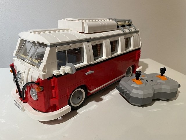

  3. Remote Control Conversion of Lego 10220 VW Bus. Motorized with M motors for steering, drive and roof. 2 pair of Power Function Lights (front and rear) Using Buwizz or CaDa battery. Instructions available at https://rebrickable.com/mocs/MOC-64460/ https://www.youtube.com/watch?v=3aC342ZdnlQ
