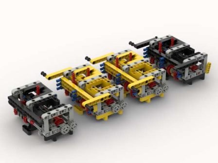

  5. Hi all, a while ago I posted about my 63 speed gearbox MOC using 6 switches and some people here asked for build instructions. These are now available on Rebrickable for those interested https://rebrickable.com/mocs/MOC-40533/TechnicBrickPower/63-speed-gearbox-including-reverse/ youtube:
  6. Hi Jurss, Good point, thanks. Creating one gear selector for 256 gears would be an interesting challenge... For me the point is having fun and trying out my ideas - I find that often ideas that initially don't seem to have much use come in handy when you're trying to solve another unrelated design problem. Hi Erik, Good question, you had me worried for a moment . Maybe it wasn't clear in the video but S0 and S1 are combined into a single 4 way switch. As well as S2 and S3, so the fact that S1 and S3 have the same ratio doesn't matter. S0 switches between 2/1 and 1/3 and S1 switches between 1/4 and 5/3 so that means you can make the following four ratios [2/1 x 1/4, 2/1 x 5/3, 1/3 x 1/4, 1/3 x 5/3] = [1/2, 10/3, 1/12, 5/9]. Similarly S2 and S3 make [5/9, 1/12, 5/6, 1/8], and even though these two have common ratios (i.e. 1/12 and 5/9) they are used on different branches of the two differentials. If you study the output over input (O / I) equations you will see these do not cancel out. The same holds for S2 and S6. So yes I am 99% sure that the 256 ratios are all different.

  19. Today is PI DAY! A very important day for all mathematicians to celebrate. What better way to celebrate than combining it with Lego Technic?! Here I present a PI Day special Lego Technic MOC that produces a gearing ratio of PI to 6 decimal places. This is using two differentials to produce a gearing ratio of 355 to 113. Happy PI Day.

  22. Hi guys, thanks for the compliments. My background is software and electrical engineering so yeah my ideas are inspired by binary, programming & circuits. Yeah am working with someone to make one available. The design is actually modular - you can repeat the middle unit to expand the design to any number of binary digits (may not work in practice - only theory!!). If anyone else is interested in the build instructions let me know. Haven't tried loading it much but that shouldn't affect the gear ratio long term - however initially it may as the gears can have some delay in them.
