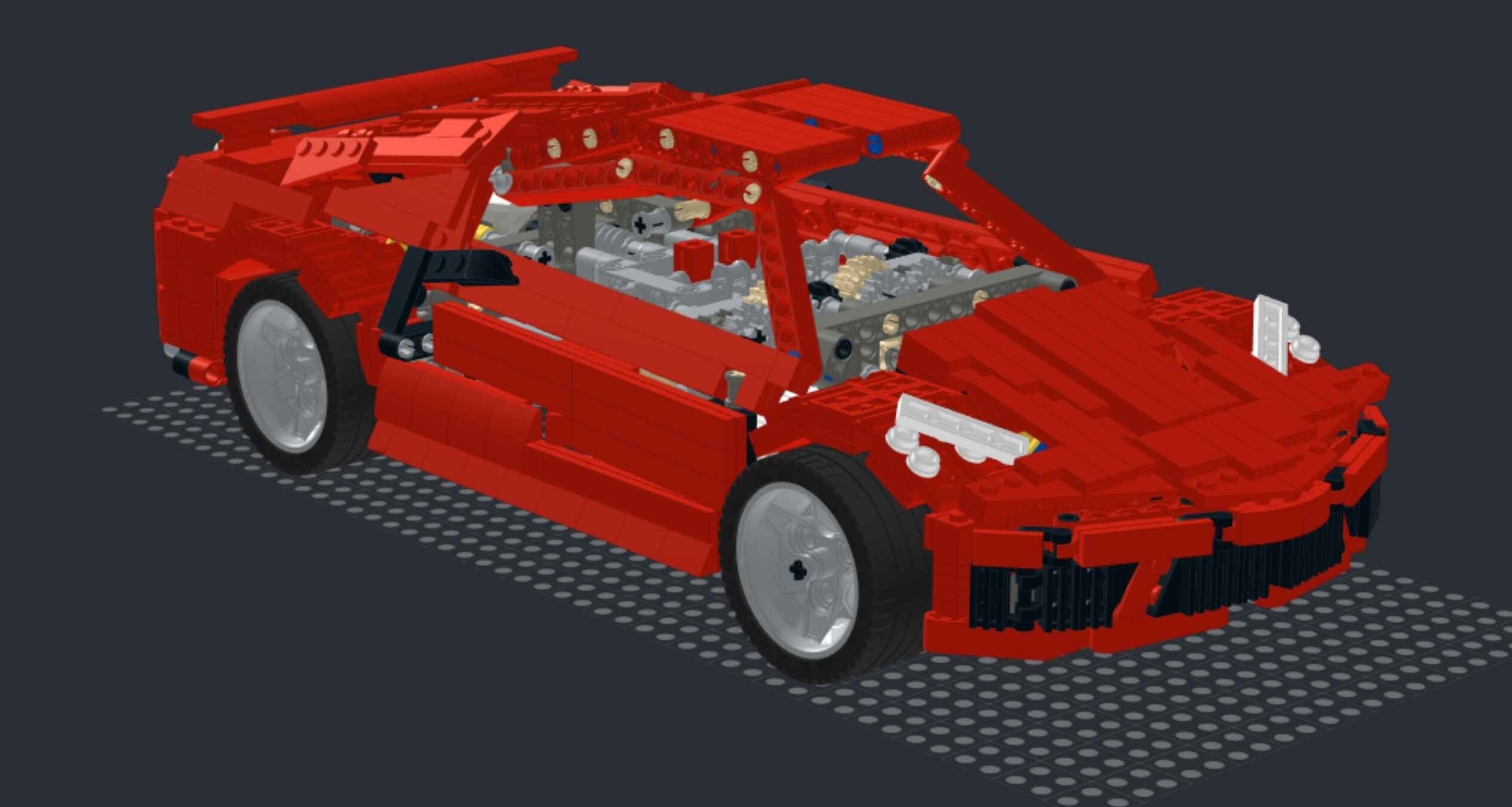

  1. Yeah, after talking with some other people, my 4 gear transmission seems unnecessary. I'll use that space to put in 2 additional L-motors. The car also has a built-in suspension very similar to the Mantis you mentioned. Does a second buwizz provide additional speed, or just runtime? Not sure if I can justify buying a second one lol. I attached a picture of the car; it's not finished but that's more or less what it will look like. It's about fifteen inches long. It looks like the picture didn't upload... Here it is again:
  2. I'm designing an RC technic car (C8 Corvette) in Stud.io that I want to race against some other people. How many L-motors will I need to get the car up to a reasonable speed? (I'd like it to go around 5-10 mph, basically anything faster than a slow crawl). I have 2 L-motors built into the car right now, but I have a feeling they won't be powerful enough. I'm planning on using a BuWizz battery pack for power and bluetooth control. The car has around 1200 parts, so it probably weighs 3 pounds or so. I built a four speed sequential transmission into the car as well. For a car of this weight, should I use 4 L-motors?
