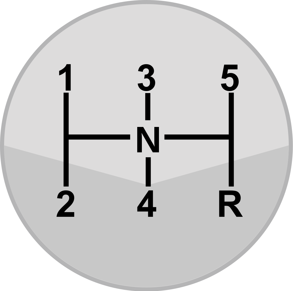

Currently in the process of rebuilding the entire frame of my MOC. Will be sure to do so! Awesome to know that you’ve seen my project! Big fan of your realistic gearbox! I’m also planning on motorizing the shifting mechanism using two servo motors and a joystick IR remote set-up (similar to the video below) with a proper shifting knob pattern “guards” to prevent selecting while engaged. I’m most likely going to try to get in contact with either Sbrick or Buwizz to see if I can get a shifting pattern profile programmed (like the image attached below) once I get to that stage of motorization. I’ll keep in touch if I manage to pull that off for my MOC! Buwizz’s ludicrous mode may win over Sbrick however since I was confirmed by their support that servo motors react quicker in ludicrous mode which would reduce the chances of selecting gears whilst engaged. iPhones recently got a game controller support update so also look forward to seeing your gearbox controlled by a game controller joystick in the future!
