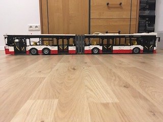

  1. This is the link to my flick account. https://flic.kr/s/aHsmayYQB9
  2. Yes ist has. It is dependent from the angle between the first and second section of the bus. It is also called forced steering, I think. Only liftarms, axles and Axle Connector Double Flexible (Rubber). Yes it is a little bit slow. At this time, I have several ideas but no time...
  3. Hello, in autumn 2017 I finished my truck with trailer and I planned to build a bus. Not even a normal service bus. I planned an articulated Bus like the Mercedes Bus CapaCityL. The result should be so realistic as possibly (in according with the possibility that ist to build with only technic bricks). Very important were the following requirements: front and rear axle as independent axle low floor controls bei IR suspension on all axles kneeling only lego parts!!! After a lot of prototypes I finished the bus in beginn of summer this year. The bus has a length of 130 cm and a weight of 6,6 kg. It is driven by 2 L-Motors on the third axle. The motors are in the rear on the left side above to each other. It has 1 L-Motor for 2 pneumatic pumps in the rear under the seats for the kneeling on every axle and the the swinging doors. It is controlled by IR. The power supply I installed only 1 battery-pack. From the front up to he back the bus has the low floor. I'm very proud auf the result especially the folding bellows I build only with lego bricks. The only part isn't Lego is the hose for all the pneumatic. :-( I needed app. 18 m of the hose. Videolink:
  4. Everything is ok. I like it! Wish you a nice weekend.
  5. My right name is Steffen Kroll. Maybe I can do this tomorrow, when I have more time to write and to collect good pictures.
  6. Hello everybody, I also built an articulated bus. I was inspired by the Mercedes Benz CapaCityL I saw on a youtube video and when I visited Hamburg right there. Then I saw this threat and I will also show you my bus. On follow video link you can see the final result. Lego CapaCityL yours Steffen

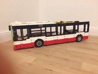

  7. What a great Project. It reminds me to my childhood. I used the similar in GDR to reach the "kindergarten". After all the good memories, I started als a LEGO- Articulated Bus. Its a Mercedes Benz CapaCity L.
  8. After some test with the whole elctrical Equipment, the front axle wann't strong enough for the weight. So I have to redesign the axle. So I have to excuse. I'll take pictures, when I have a new front axle. Steffen
