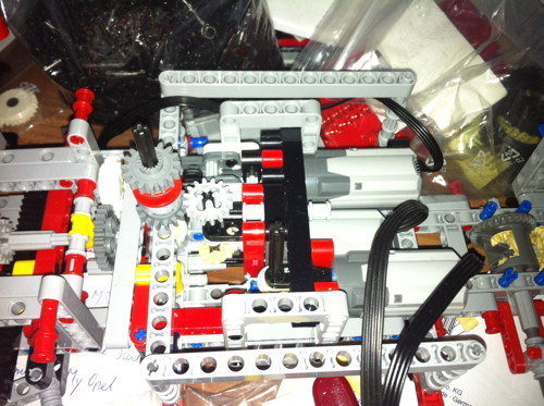

Grader Volvo G940C
AdamL replied to AdamL's topic in LEGO Technic, Mindstorms, Model Team and Scale Modeling
Hi, here one picture form inside. -

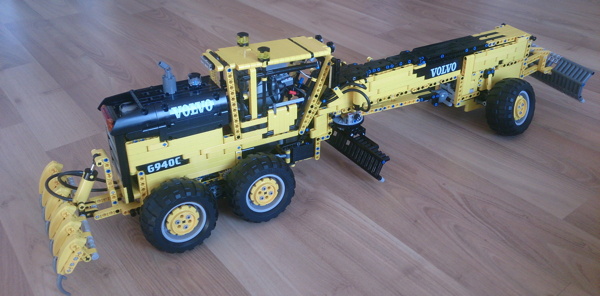

Hi Guy, i will show you my last Project. A Grader in Scale 1:12,5 and Style form Volvo G940C. I build this one this year for Bricking Bavaria 2016. The Grader have the most Functions then the real Model. One Function is missing. Here a list of the Functions: 1x L-Motor Autovalve for Lift Up/down the Front Blade 2x L-Motor Autovalve for Lift Up/down the Middle Blade 1x L-Motor Autovalve for Slide the Middle Blade Left/Right 1x M-Motor Autovalve for Lift Up/down the Rear Ripper 1x M-Motor for Compressor 1x Servo for Steering 1x M-Motor for Rotate the Middle Blade 1x M-Motor for Articulated steering 1x XL-Motor for Drive 1x M-Motor to change the Gears in the 2-Speed Gearbox The Decals are Printed on the Liftarms. Tires are not Lego. But in the Diameter have Lego no tires.
