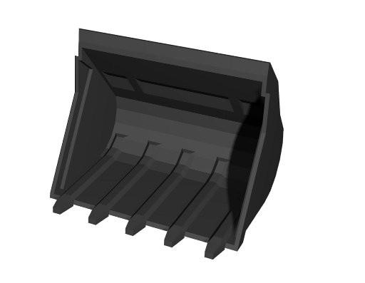

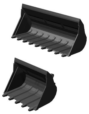

  22. I think both those buckets are too small. If the loader bucket from 8294 is to be used, the pivot point should be moved closer to the top of the bucket. I have done this to the ldraw part: It is however, still a loader bucket. 9L beams can be attached like this, to turn it into an excavator bucket:
