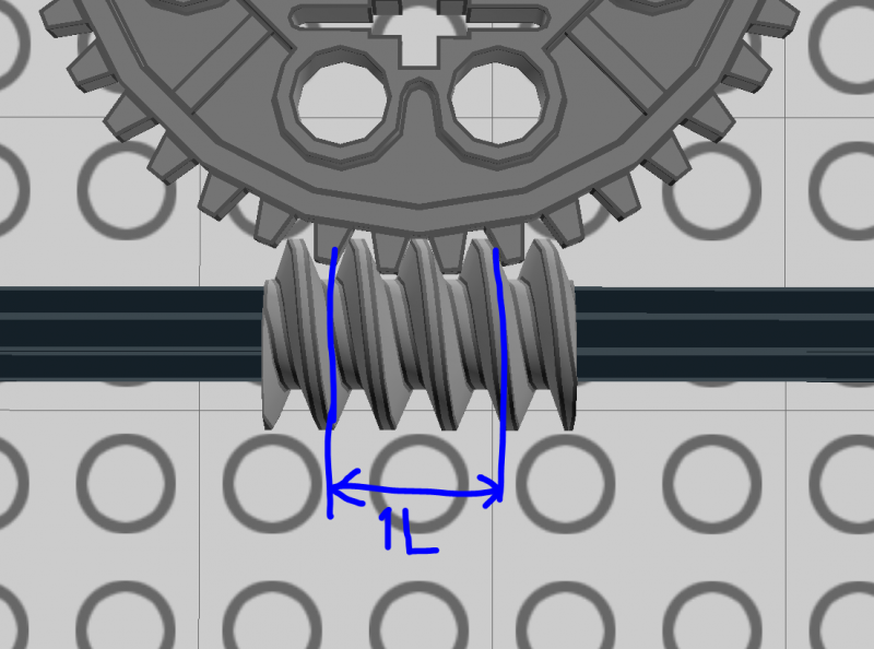

A 1L worm screw is actually a good proposal :thumbup: If the number of gears in engagement are sufficient given the LEGO gear geometry, it should work fine. But it might be too tight though to fit supportive beams on the sides.
A 3L worm screw would be good if they just allowed the axle to pass through and it had more threads :classic:.
A 2L worm is OK like you say - only that you always need bushings to make it 3L => extra parts needed in the set and extra steps in building process.
Yes, 1L works with nothing on both side.
But add a connector like 42003 or 32068 on each side. Maybe there will be a collision between the connector and the teeth. Dunno.
