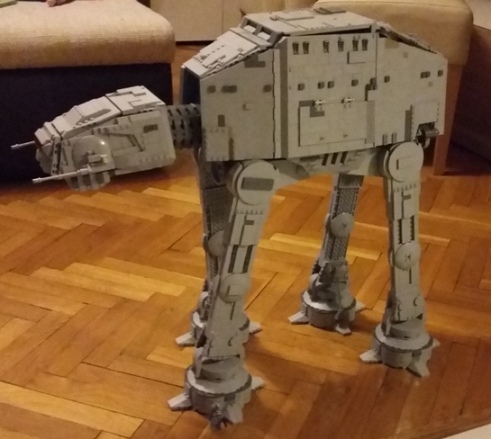

Apoc1 Posted March 21, 2017 Posted March 21, 2017 Hi!For some time now looking at the UCS AT-AT and thought I build one, this version so I chose him started. There were some other details which unfortunately only LDD version was good but in reality it did not work but after some repairs and modify (purchase of equipment) got this far. Some details are still missing but will be ready soon. Many thanks for : All in the Reflexes Quote
Miro78 Posted March 21, 2017 Posted March 21, 2017 Very nice. Always fun to see everyone's take on this iconic beast. I think knee articulation is not crucial as this heavy beast will be in a static pose. I am just starting to gather parts and playing around with building a UCS (minifigure scaled) AT-AT at the moment. I have built the feet and moving my way up. If you haven't checked out Jhae's and Mark B.'s AT-ATs, below are links to their Flickr pages. I have seen both of theirs at Legoland California Star Wars Days event that I participate in. Mark has been building them for a decade and Jhae brought his first one to an event last year. Both have rebuilt theirs since and now have a full interior, so worth checking out their photo stream. Below are links to their AT-AT albums, but they have additional photos not linked to those albums worth checking out, so browse their photo stream as well. https://www.flickr.com/photos/jhaelego/albums/72157660261281997 https://www.flickr.com/photos/23575410@N05/albums/72157625467376238 Miro Quote
All in the Reflexes Posted March 21, 2017 Author Posted March 21, 2017 (edited) 2 hours ago, Apoc1 said: Hi!For some time now looking at the UCS AT-AT and thought I build one, this version so I chose him started. There were some other details which unfortunately only LDD version was good but in reality it did not work but after some repairs and modify (purchase of equipment) got this far. Some details are still missing but will be ready soon. Many thanks for : All in the Reflexes Superb work Krisztian, its great to see it in bricks along with DarthPineapple's version as well :D Edited March 21, 2017 by All in the Reflexes Quote
