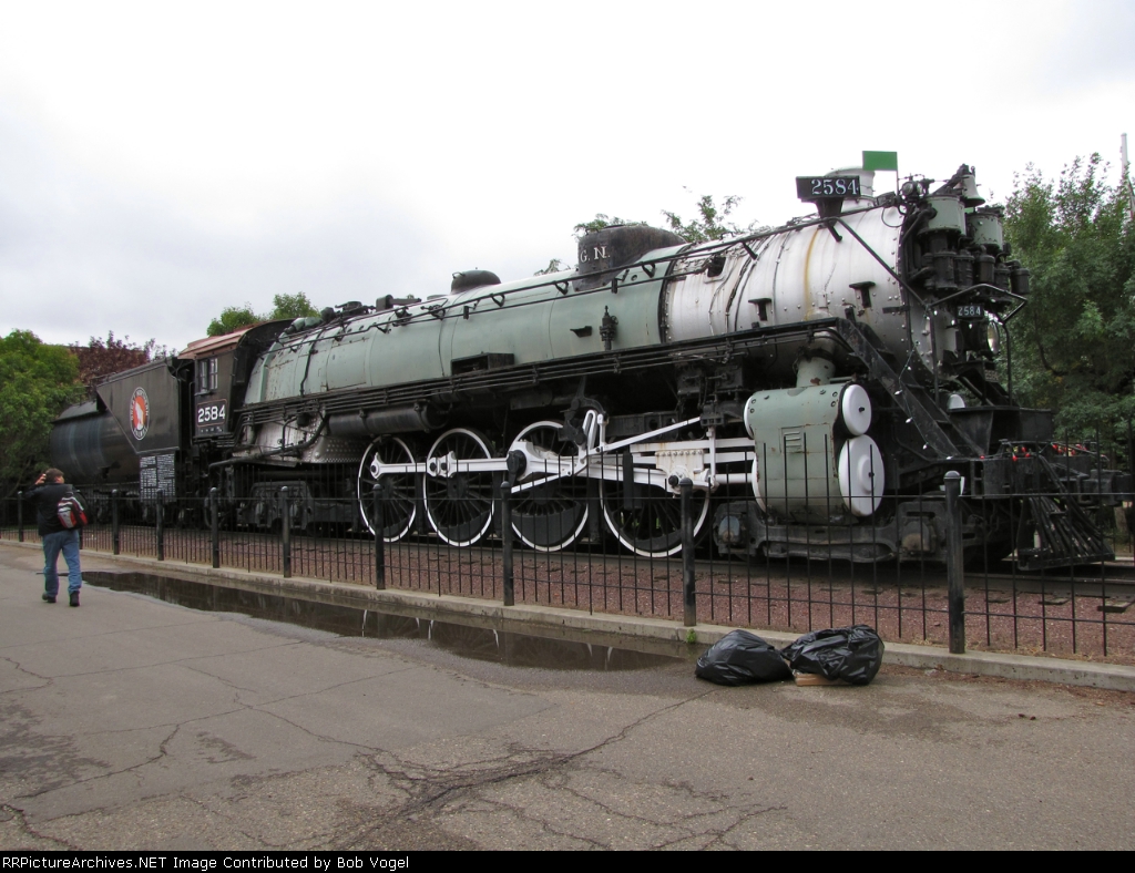

Now returning to the prototype for a moment. The Havre locomotive looks striking in its green paint, but while I was digging up reference material for this model, I quickly learned that it was the wrong color. From everything I've read, the Glacier Park paint scheme was commonly used on passenger locomotives, but it was never an official scheme. For the curious, click the small image below for the best color example of the scheme that I'm aware of. Also note the herald on the engineer's side, the goat is facing to the right. The closest lego color to the original green would probably be dark green. Still, I like sand green as the prototype is currently and I didn't want this to look like a Emerald Night MOD. Still, it has gotten me wondering why the prototype is the wrong color. GN preserved this engine and then BN, so it is not like some misguided town repainted it in the faded color after years of neglect.

You are correct about the color of the loco the paint charts I have for the glacier park scheme are much darker. The color is officially called boiler jacket green and is more like the darker LEGO green. There was some controversy over the color when these locos were repainted as to whether the color used was correct.
There is a Great Northern 4-6-2 pacific number 1355 that is being restored the running condition in Indiana by the Siouxland historical railway society that is closer to the original color.
Ah, good catch. Here's a shot of it...
